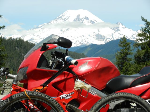

 I have both and yes Gen II is superior as it protects the grips better.  However I used this PVC pipe mod with the CD to protect the grips on my VFR and other bikes. It works like a charm!
[image: med_gallery_2144_2004_319941.jpg]
You can see also that the original CD with straps will ride a little closer to the fairings than the new version.
Thanks, BonusVFR.
When using the original one, does it tend to twist the grip enough that it causes the throttle to open?
Not that I am aware of?  I think I only used the CD once before I added the PVC protectors.
