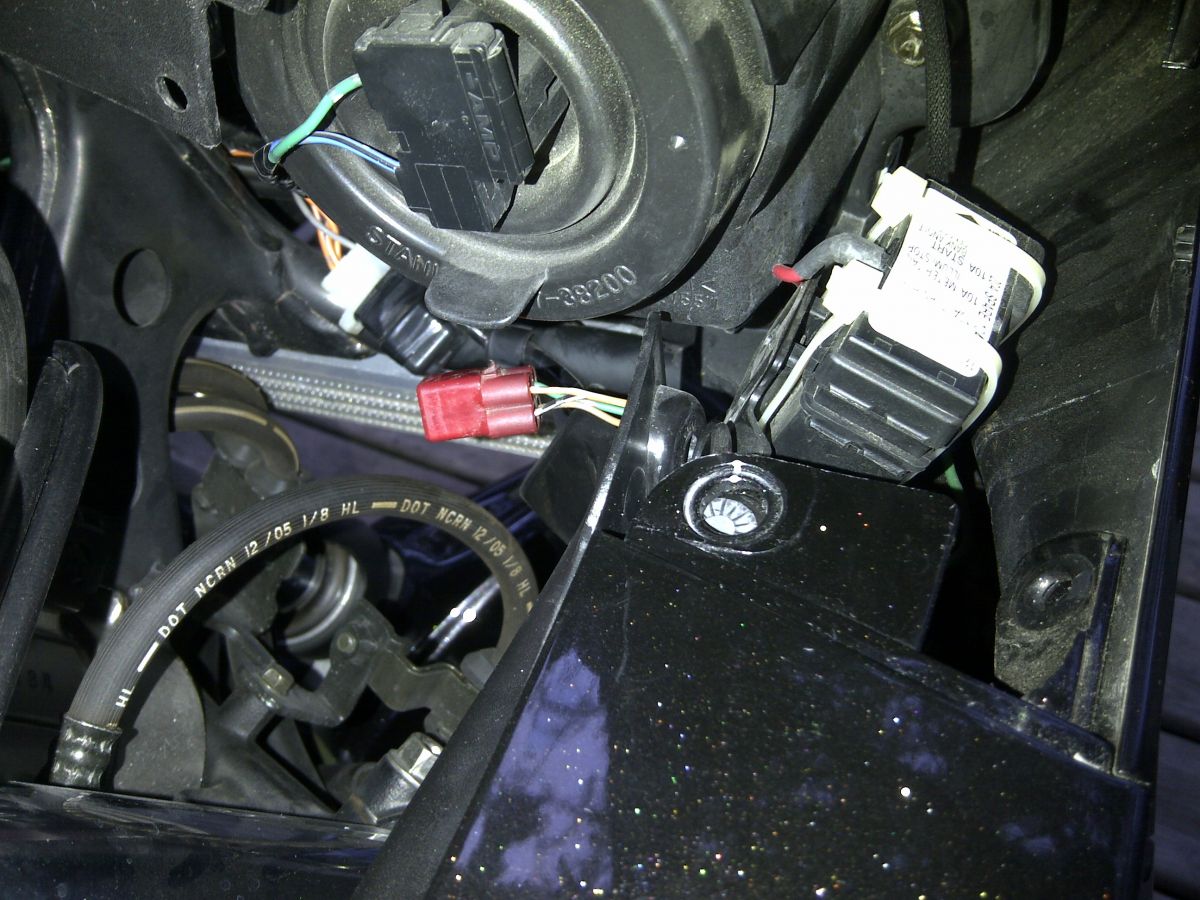

Let's get on with the installation of the HealTech GIpro DS GPI. Per the included instructions, locate the DLC:
gallery_14465_6018_1363522.jpgDLC connector (red) location behind right meter panel
In the photo above, I still have the right meter panel removed. It is not necessary for the right meter panel to be removed. The DLC can be accessed with the VFR fully assembled by design. Next step, remove the DLC cover:
[image: gallery_14465_6018_410788.jpg]DLC connector cover
Not being the best photo journalist, you may have noted that the DLC cover had already been removed in the previous location photo.
By now it's getting dark and starting to rain. I hurried the rest of the job and didn't take any more photos of the installation. Well there's not much to show anyway. Just connect the harness end of the GIpro DS to the DLC. It's got a nice gasket inside it just like the OEM red cover. Should keep all the crud and corruption out of it quite nicely.

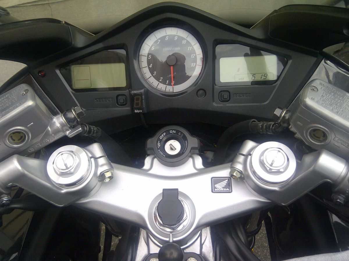

Lastly, mount the indicator in a appropriate location. Here's my first location - still under consideration:
gallery_14465_6018_913962.jpgGIpro DS location
It's nice and small and fits rather well there up on the instrument panel right next to the tach. Just a small section of unobtrusive cable showing for it as it runs from the display up under the meter panel and across to the DLC.
Certainly easier to see than the Acumen's location choices which were restricted by the fact that Acumen's DG8 has its cable coming straight out the back of the unit near the top edge.
The only thing I'm not happy about with its current location is that it is slightly off angle and facing slightly off to the left. The meter panel is beveled from the middle sloping outward slightly to each side. Thus, the GIpro DS is not facing me square on. This really doesn't affect its visibility in any practical way but it is slightly distracting to me - or should I say, aesthetically detracting to me. Yeah, I'm just that way. The good news is that HealTech had the foresight to anticipate that some customers may be suffering from OCD like me and thought to include an extra double-sided mounting tab so that the unit can be relocated using their high quality adhesive tape. I'm thinking about making a thin beveled adapter to counter the taper of the meter panel cover (did I just say that out loud?). That's not something I'm gonna rush off and do. It can wait.... until I can make the sweetest of adapters that's perfect in every regard!

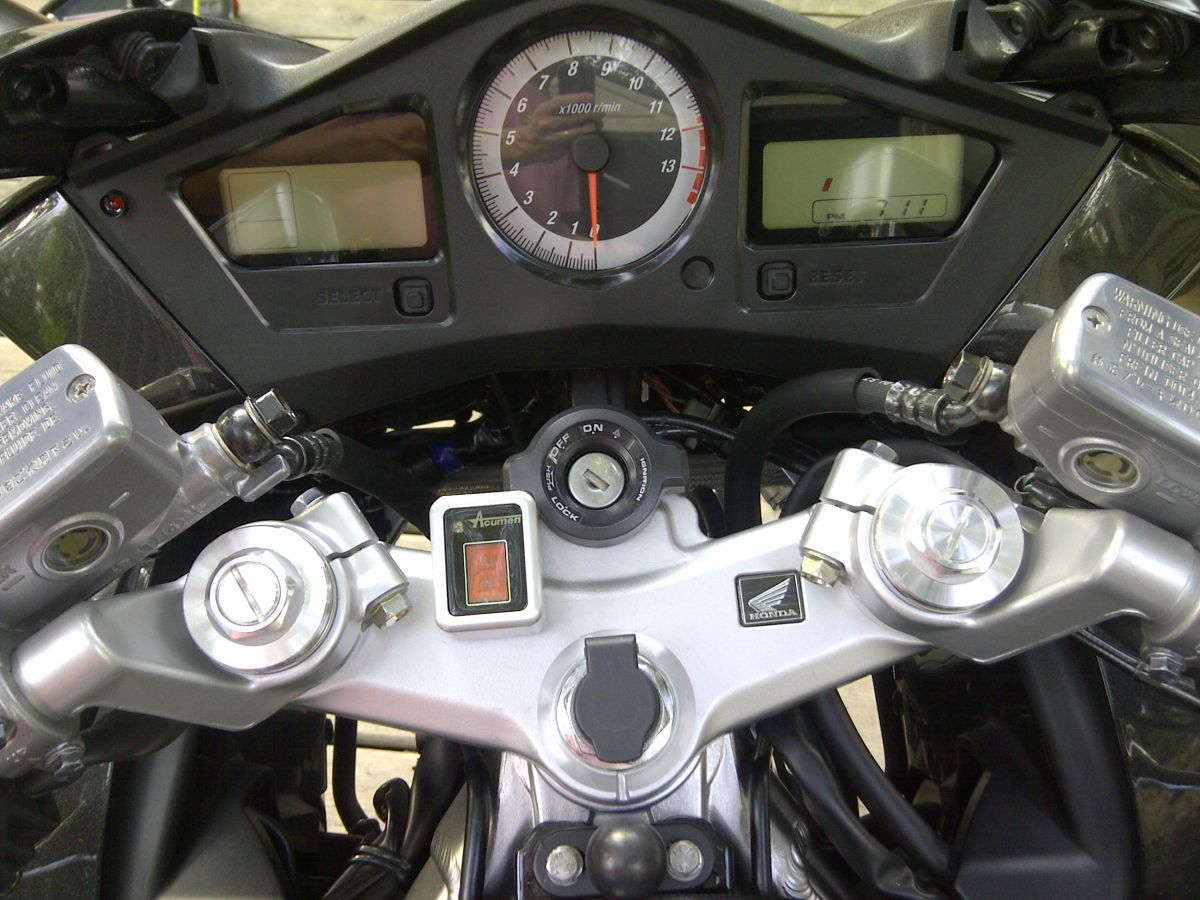

I just wanted to share an alternative mounting location for the GIPRO that I recently used. Thanks for the suggestion Crazybrother!
[image: post-21889-0-77384500-1336517025.jpg]
[image: post-21889-0-83917700-1336517045.jpg]
[image: post-21889-0-05690300-1336517059.jpg]
