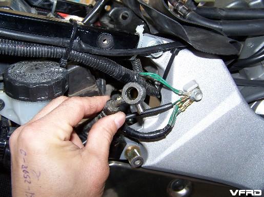

So I got to do a bit of work on the rear brakes this weekend.
First off, after removing the LBS plumbing to and from the front end, I took out the front/rear proportioning valve.
[image: user posted image]
This is also where the main ground from the battery is connected, so I had to reattach the ground cable to the frame afterwards using a much shorter bolt. You can see the ground cable hanging out in the breeze in the pic above.
