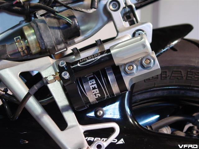

Remote res & preload adjuster mount I ended up routing the hoses separately for clearance so they didn't rub on anything.
Remote res and preload view 2 The goal was to have a sturdy mount and still have access for all adjustments.
I also still wanted access to the lock. The helmet lock still works, although it's a little tougher to use.
[image: gallery_4940_1398_27376.jpg]
Final location Final mounting location with one hose on each side of the footpeg mount. There is still room to get the key into the lock.

It looks like Wilbers donot place the banjo bolt in the same place/hose orientation on each shock because mine has no interference whatsoever... With the banjo bolt facing towards the back, the hose points towards the left (where the SSA/chain is). Wilbers advises NOT to place it on the side where the chain is (in case it snaps?), but on the other side is my -hot- high mount exhaust...
Nekkid!
[image: HPIM7000.jpg]
My fuel petcock is 100% tight (IMG:style_emoticons/oldemoticons/fing02.gif)
Turn in the adjuster of the 4th geb shock as much as possible to give it as much clearance as possible when fiddlign the shock out

Your hose hangs out the same way mine does! (IMG:style_emoticons/oldemoticons/goofy.gif)
On a more serious note, you will see what I mean when you try to put the front of the battery box back in. It will hit the banjo bolt until you"modify" it.
Mounting the external adjuster in a good place is the difficult part. Enjoy!

The heat shield *just* touches the the banjo bolt; unless ENZED tells me I will crash burn and die again, I will leave it "as is"
[image: HPIM3508.jpg]
No shit, Sherlock!!! on fitting the remote....
The extra footpeg hanger came in, but I need to figure out how to transfer the lock AND find someone with a big enough saw.....
So that option is on hold.... I ended up fitting it about three times, ok-ish now.
I know Wilbers says not to mount it over the chain, but I donot want it near my exhaust. The next exhaust will be even higher mount...
[image: HPIM3523.jpg]
Look! CF hugger in the background!
Other side:
[image: HPIM3528.jpg]
(Do I smell chicken? (IMG:style_emoticons/oldemoticons/tongue.gif) )

RVFR2, Feb 3 2007, 05:58 PM[image: MVC-019F-1.jpg]
Looking good (IMG:style_emoticons/oldemoticons/fing02.gif)
Am I seeing correctly that you used rivets? (we call them popnagels; pop nails...)
Where did you rivet them onto? The subframe by drilling holes into the frame?
I've relocated mine to the same position as jstanwood for now.
The hose on the Wilbers may be just a tad too short too fit in the space behind the grab bar if I remember correctly. But will see tomorrow.

Dutchy, Feb 3 2007, 02:17 PM
Nope, those are screws with a wide head with a machine sheet metal type of thread
