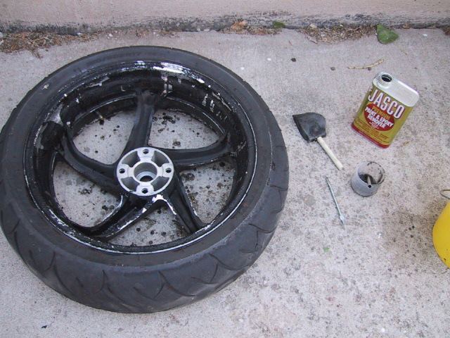

Apply the stripper the can is enough for both wheels
make sure to get all the knooks and crannies.
IPB Image

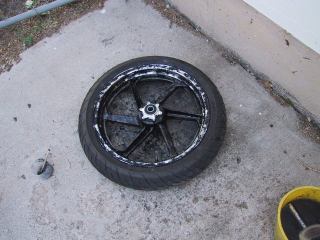

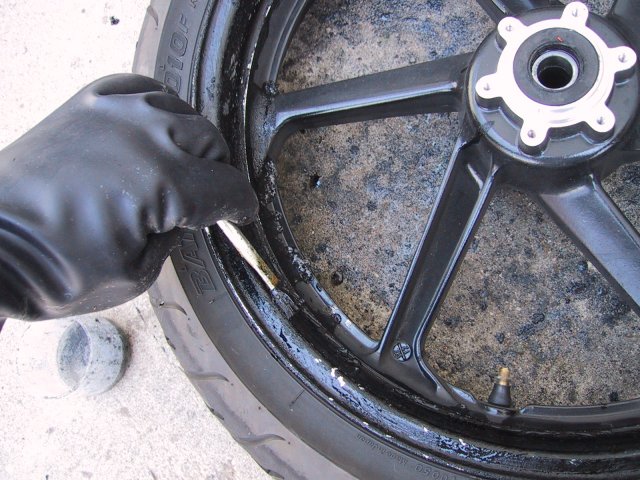

Only takes 15 min for the paint to blister off, the stripper will eat a foam applicator (trust me heh) use a metal or wood brush with nylon bristles, then discard when your done.
IPB Image
Wash off exess with a hose use a nozzle for hi pressure washing, carefull dont get any of it on you, and wash it all away, keep the kids away and animals this is not for them! clean up any paint residue and dispose of properly. The stripper is water soluible but is dangerous. wear eye protection full length sleves and long gloves.
[image: IPB Image]
You will have to repete the process untill you get all the paint off, I would do one wheel then wash it then do the other while that one dried, this is where I used the fine steel wool too, dipped it in stripper and had at it!

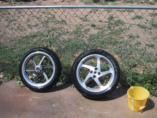

I then applied Mothers Mag Polish and rubbed away till it shined.
IPB Image
What do you think?
[image: IPB Image]
I am going to have to paint or grind down the front spokes and polish them since they have this rough finish to them.
They get dirty of course, but the upkeep is about as much as they were before, getting the chain wax off, tar from the road,  They dont seem to tarnish its aluminum.  Just about the same as the oem paint wheels. :cool:

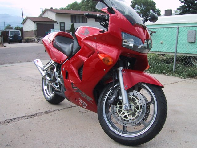

It's easy to tape off both wheels. It took me a Saturday and here is the finished product.
