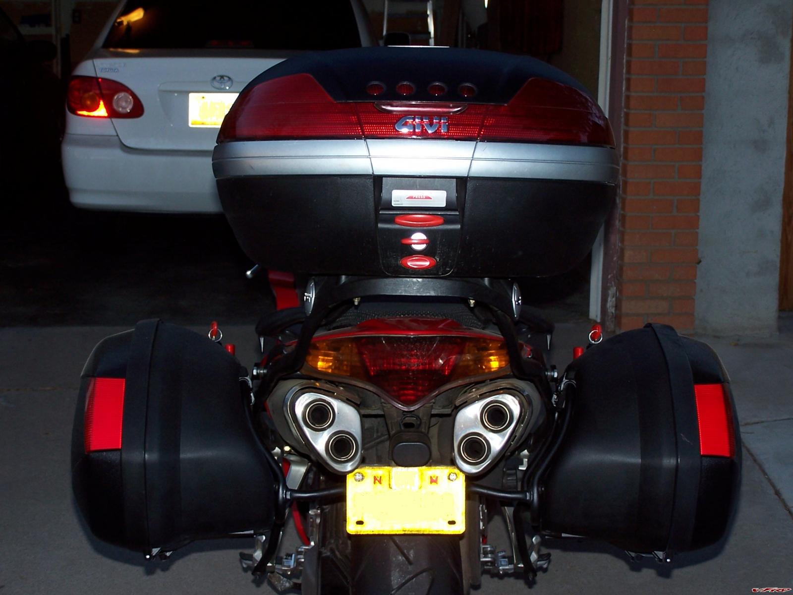

My Givi V35 side cases are form fitting but these are not "quick release" brackets. Mine stay on year round. I do have a fender eliminator kit installed so getting around the license plate issue was pretty simple for me.
LP Bracket
