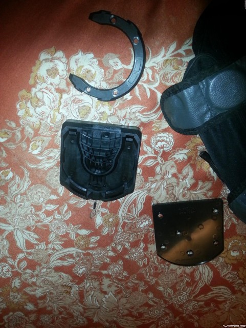

  Paid about 60GBP  abt 90 USD + shipping (could have got a new tank bag). the kit came with the tank ring, bag adapter and the necessary fitting screws.   02. EVO Tank Ring
02. EVO Tank Ring

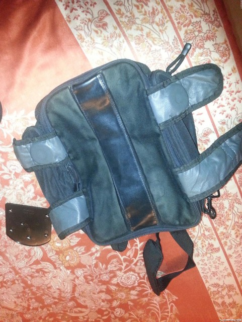

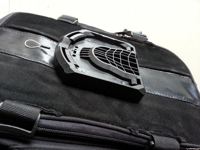

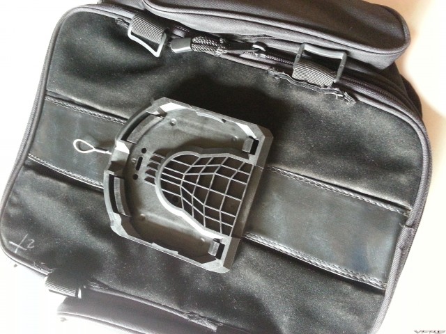

Positioning the adapter is critical - so it does not interferer with the handle bar movement and sitting. Tried to keep it centered on the bag. Chopped the tank bag magnetic ears !
03. tank adaptor position
04. Tank adaptor alignment

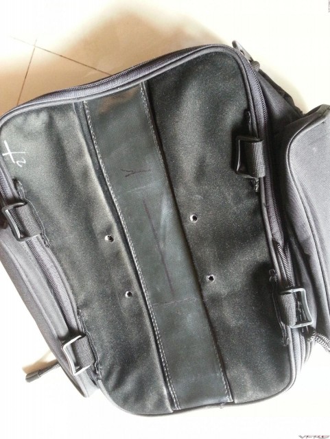

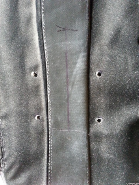

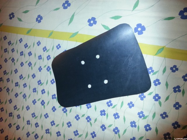

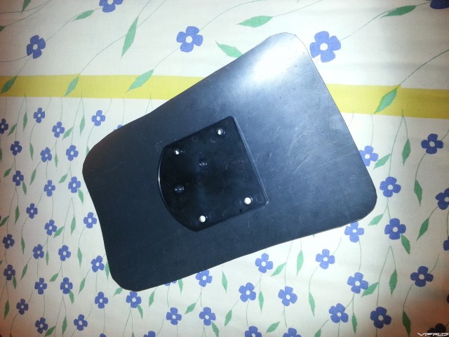

The bag has a soft base, so it needed to be reinforced. Used a fiber (from a local bag repair shop).
05. Fiber hole tracing
06. Fiber holes
06. Fiber holes
Made necessary holes on the bag. They had supplied a drill bit - since the bag is soft, used a punch.
07. Holes In The Bag
08. Holes In Bag   2
08. Holes In Bag 2

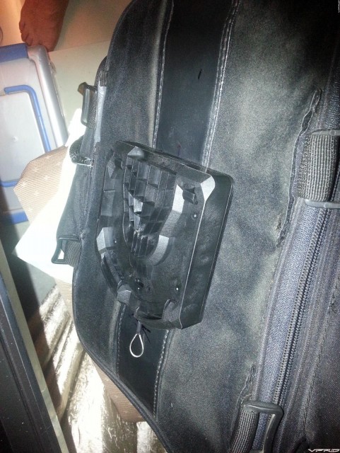

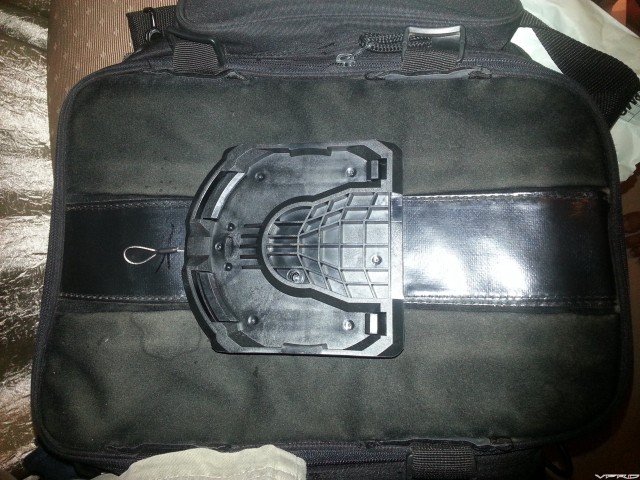

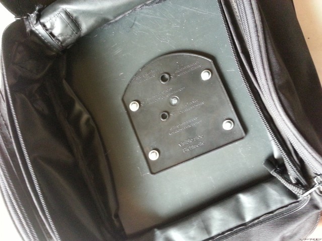

  now to put it all together   09. Adaptor installed   inside
10. Adaptor installed   outside
11. Adaptor installed   side

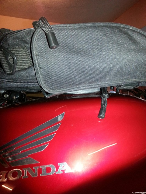

  The bag now site about half an inch about the tank. Pretty secured. The fiber supports the base preventing it from sagging.    12. Tank On Bag   clear Gap
  need to be tested on load.
