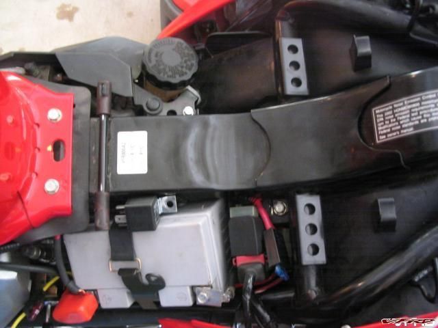

I recently found a great compact fuse panel, which takes care of all my needs. It is rated at a max of 15 amps per line, 50 amps total. Here is the mounting process:
Starting out:
Cleaning the install area:
[image: med_gallery_11291_3273_554121.jpg]
Peeling double-sided tape from Relay to mount:
[image: med_gallery_11291_3273_501388.jpg]
Peeling tape from Fuse Panel to mount
[image: med_gallery_11291_3273_260550.jpg]
Mounted, note the ground location(green wire):
[image: med_gallery_11291_3273_411555.jpg]
Fuses mounted, the white wire is my trigger wire, it is connected currently to the tail light, but for those using my harness there is a no-cut option on there:
[image: med_gallery_11291_3273_325957.jpg]
All finished, with cover on. I have nothing connected, but power was present at all 4 terminals just as it should be:
[image: med_gallery_11291_3273_488427.jpg]
I hope this helps people, especially those with 6th gens and no room!!!
