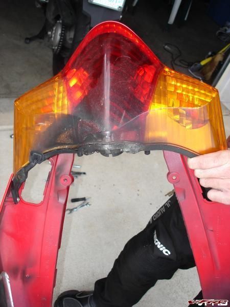

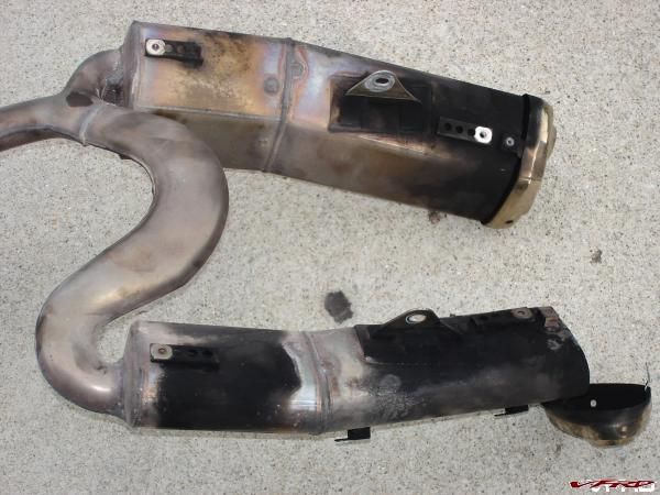

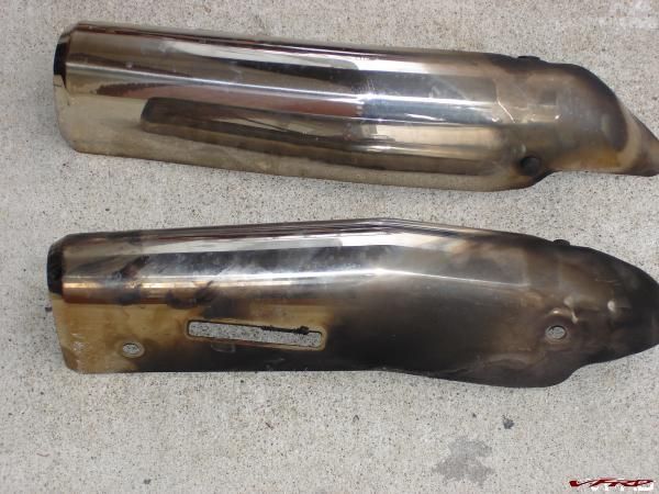

I have what happens without the fix....
billyjackjimbobI have what happens without the fix....
You are the reason for the fix!
So why on earth would you buy another VFR? Those are some crazy pictures.
I just want to get my vfr fixed. Make sure everything is ok (run it for 300miles) and then sell it. My VFR days are limited.

What's funnier is to hear him tell it in person, with or without the people that were there telling him it was on fire, when there were flames coming out of the bike. His bike literally burned down and Honda bought him a new 07 RWB after not being able to fix his bike, and issuing the wiring harness recall because of his bonfire.
