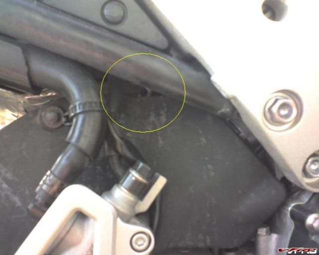

I mounted the remote on a bracket that bolts to the back side of the left rear peg bracket.

I have put the CBR929 shock on my '02, here is how I did it.
3 problems you run into:
1) Shock length is wrong, too short, I made a top mount like they are doing on the 5th gen and I think the F3 shocks, I don't remember the measurement, but it needed to be longer, and I like to to my own calculations anyway so I know it is correct. I also made a longer one to raise the tail of it
2) The brake proportioning valve bracket is in the way of the reservoir on the shock, you need to cut it and make a new piece to weld in. The picture trys to illustrate it. You have to at least undo the top subframe mount and pull this thing out of there. Cut it, weld a new piece in it, paint it, put it back in, sounds easy, it is a little work though. Sorry, no pics from my bike, it is a little work to pull out and didn't take any before I put it in.
3) Shock reservoir hits the brake lines next to the rear cylinder head. There is no way to take a pic of this, but the reservoir is really close to the cylinder head, I just had to push the metal brake lines that were in the way up a little bit, not much room at all, but I did make it work.
I tried to flip around the reservoir, you would have to move/cut more stuff. Here is a pic of the compression adjuster, just requires a little longer flat head screw driver. Access to the preload is quite easy from the left side. Rebound adjuster is in the stock shock's position.
CBR929 shock on VTEC, showing comp adjuster

Please see the pic on post #20 for how tight the fit is:
Honestly, I'm struggling to remember exactly how I sneaked it up in there, but what I do remember is:
-having on the centerstand with rear wheel removed.
-then I tried several different positions of the swingarm to get it to slide in, including using an adjustable strap to hold the swingarm in whatever position I was attempting.
-almost gave up.
-tried again, without the adaptor.
-finally got it in.
-replaced the adaptor. If I remember right I had to keep the adaptor somewhat loose until I thread the top mount through and got the nut on top started.
I realize that isn't as helpful as you all might like, but I did this a while ago. :unsure:
Hi guys,
I am the other guy who couldn't get it to nstalled but finally did it without any mods.
I followed the same procedure as Slow here after getting confirmation from Jamie to assure me it fits, and that is removing the adaptor Jamie builds for the shock to get everything in place and then screwing it back on.
This is all with the reservoir facing the front and clearing the cylinder head by only a few milimiters. I know this may affect shock performance in the long run due to heat build-up but will try as it is before doing any mods the brackets. If I find it too bad then I'll look at making the necessary changes to install it with the reservoir to the back.
So it can be done without mods, you just need to remove the adapter first.

Unless the hose to the adjuster is cut / removed, R/R'ing the rear shock on a 6th gen ABS is a royal PITA. Turns what should be a short job in to an all day project. I had Jamie rebuild my ABS shock, but I could see why some wouldn't. Well worth it though!
#206
Cogswell

#250
Yep that was my solution and still holding strong years later.
THe only reason i had to chop into the battery tray was that with a passenger on the bike, i found the reservoir [mounted in same location but prior to cutting the battery tray] was pushing on the brake lines.
This solved it.  Yeah i should really invest in some nicer clamps instead of zip ties but when you are standing looking at the bike you barely notice it.
pic from a couple weeks ago
[image: 20200519_123018.thumb.jpg.74915a02bb0c3ef4a4550f895010731f.jpg]
#255
That'll work!  I like the black remote canister, looks sleek
At some point I removed the front zip tie showing in my old pic above.... the other two are relatively 'straight' and are not noticeable
No issues in the 4 years or so that I've had the shock
