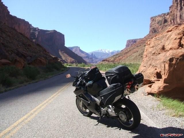

I have Nelson-Rigg bags, worked well with the OEM exhaust, but the Scorpions got a little too hot, so I made heat shields for them to prevent direct contact with the can. My first set were aluminium (painted black), then made a second set from stainless.
[image: HS7jpg.jpg]
[image: SS2.jpg]
[image: SS1.jpg]
Lee 2002

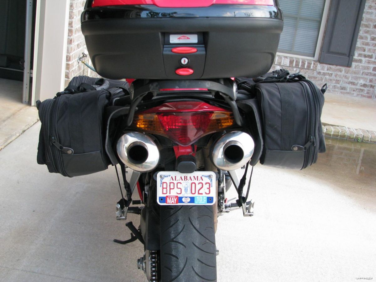

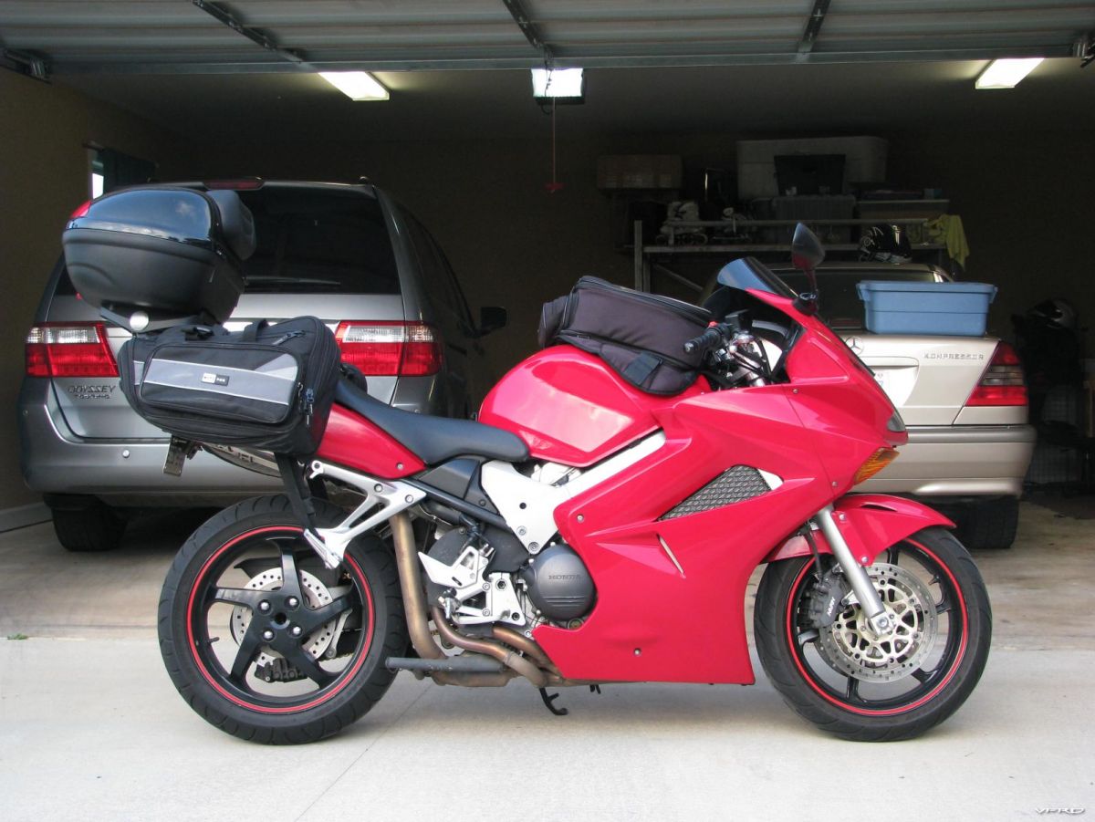

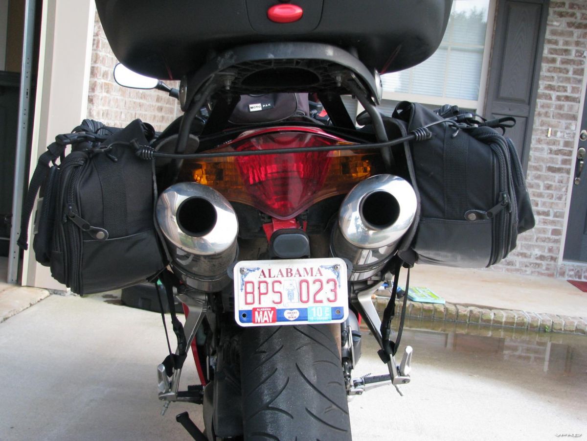

I bought a pair of Cargo Basics Endurance sport saddlebags from Cyclegear to go with my Givi E460 on longer trips. They work great, don't interfere with the passenger pegs, and are expandable to carry tons of stuff. They balance pretty well and don't seem to add alot of weight to the bike either.
HOWEVER... the clip fasteners that come with them are freakin worthless. I remedied that by ordering a pair of fasteners from safetycentral, and having a local seamstress put them on. With the new fasteners and a bungee cord on either side, they work pretty well. If you end up going with a pair of softbags with those quick-release type buckles, make sure you fasten them and then yank them around and put them to the test... if they show any signs of loosening, either buy another brand, or be prepared to do what I did and buy your own clips.
I've had no issues with heat from the exhaust damaging the bags or their contents, and they sit right up next to the heat shields. The bags don't interfere with the passenger pegs either.
[image: P4240382.jpg]
[image: P4290671.jpg]
