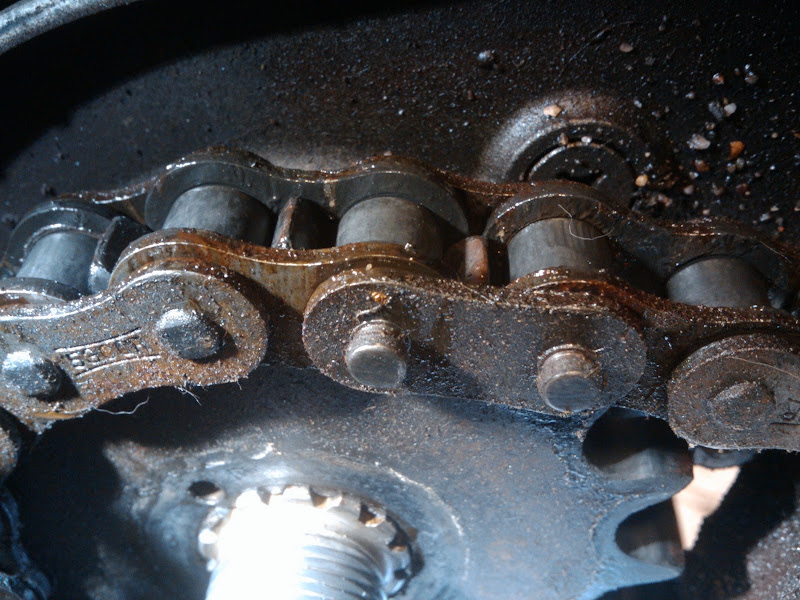

here's something to think about, found this while changing my own chain

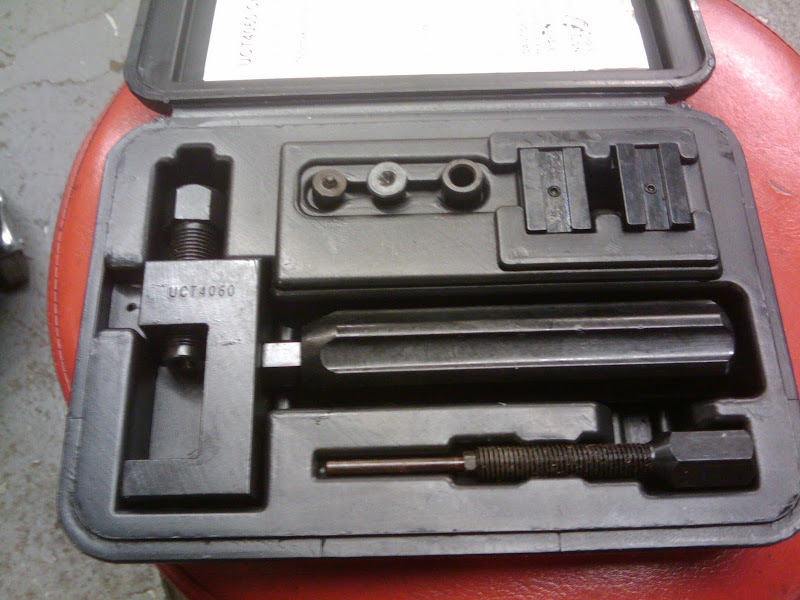

this was my next purchase
