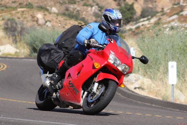

I have been using soft bags on my 5th gen since I started VFR touring. I have always had more than a bit of 6th and now 7th gen envy as regards the OEM racks and bags, especially as my tour escapades expanded. This is an elegant OEM solution and the PLX Givi cases with either the Givi or SW-Motech racks look to be a comparable alternative.
While my Cortech Tribag softbag setup has worked well for years, I have examined many hard bag options for the 5th. There are many possibilities but none are as elegant or have the utility IMO as what the Vtec has on the factory option list.

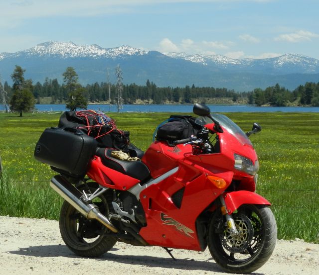

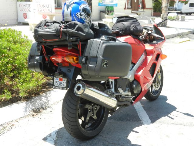

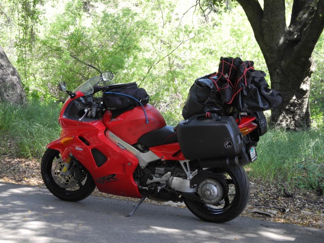

I upgraded to a hard bag rig this summer prior to a tour to Idaho. I elected to go with SW-Motech racks and Hepco & Becker 30 liter bags. I strongly considered SW-Motech Trax Alu Bags, 37 liter variety, like a few 6th gen users have recently posted but opted for the less expensive and slightly narrower Hepco Becker Juniors instead.
No camping gear here.
Pre tour checkout ride.

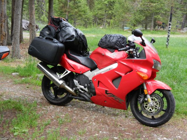

I was leery of bigger bags to gain more room as “Junk always expands to the room available”. I always carry more crap on tour than I should!

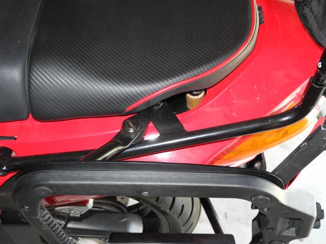

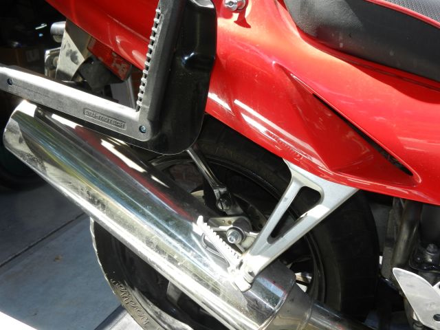

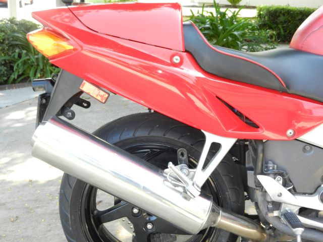

One of the advantages of the SW-Motech racks is that it just a simple twist with the fastener to add or for that remove the racks from the bike. Optionally, you can lock the racks to the bike.

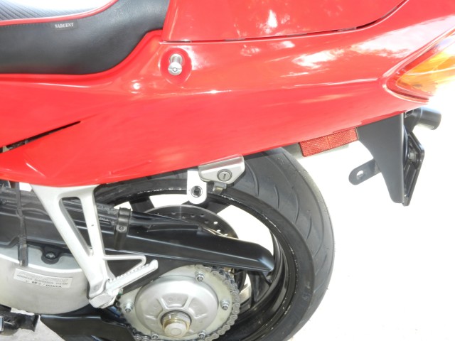

After the racks are removed only one obvious hardware piece is left. That piece attached to the rear fender thru existing holes is not that unsightly and could be taken off if it drives you crazy.

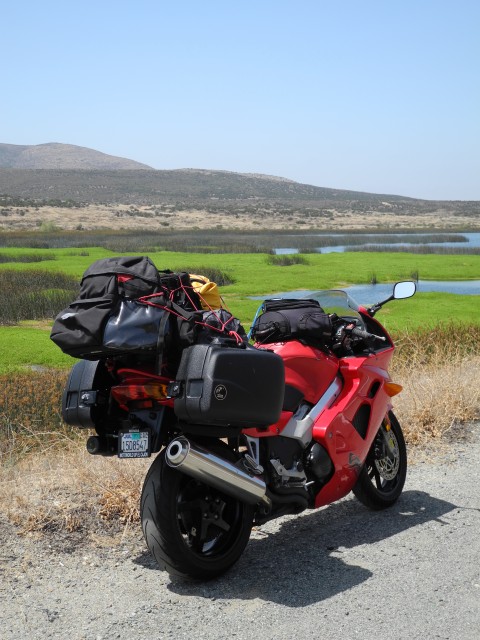

What is the width anyway? Of all the bags, I researched that had at least the capacity of my softbags (nominally 20 liters apiece) the 30 liter Hepco & Becker has the least beam.
My VFR with SW- Motech racks and 30 liter bags has beam of 38 inches. This compares to about 32 inches for my Cortech panniers. Maneuvering requires some thought if you are used to cutting through tight spaces or squeezing in to tight spaces in the garage. As regards my mirror feeler “whiskers” they are span only 36 inches even with the SW-Motech extenders. So be careful.
And for further context and a shocker for me - my Wing bags cover just 36 inches and the whiskers reach out to 43 inches. So I am pretty sure that when the mirrors clear I am ok.
My VFR with SW- Motech racks and the Cortech softbags has a 41 inch beam.
While I did not ride in the rain much the contents were dry after an evening of showers.

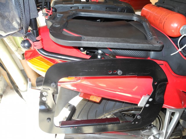

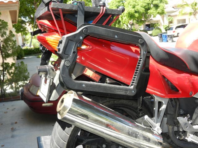

I have been unable to find a compatible tail rack at this point but built my own for my tour. Still looking though!
As opposed to tailored rack setup like the big sport touring mounts like the ST1300, R1200RT, C-14 and indeed the 6th generation, my new racks have some obvious space between the racks and bike. Perhaps, I will setup some aux storage for miscellaneous items such as tools etc.
I mounted a tool tube as a test under the left bag but will consider other stocking stuffers in the future.

My Cortech bags were top loading while these hard bags are side loading which means you need more room to pack stuff in so do not park too close.
My laptop 13inch will fit easily in a pannier. There is a modicum of security improvement over softbags but a determined thief would have no problem penetrating any motorcycle bag system I fear.
You can optionally lock the racks to the bike. Locks are included to secure the bags to the racks and to lock the bags themselves. The bags are very easy to remove from the racks.

The SW Motech was a piece of cake to put on and will be easier yet to take off since I will only remove a few bits. Most likely I will buy some spare fastners just in case.
It takes just a few minutes to get the racks off. When you take off the pillion grap handles you take off one third of SW Motech attachement points at the same time.
I would be easy to hide the forward attachment points as well. Even the rear attachment points on the rear fender can be taken off if it drives you crazy and really like the clean look.

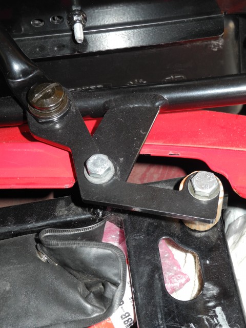

I was able to figure out a way to jury rig my Ventura tail rack to fit with the original version of the SW Motech racks.
Under the seat.

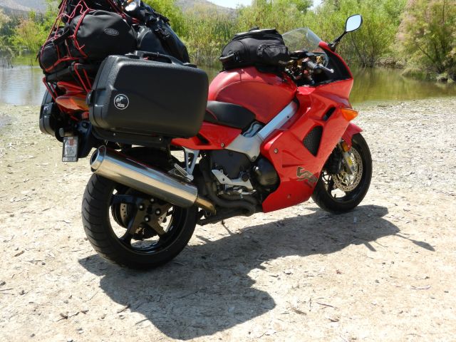

My current max loading setup.............with tent, chair, pots, pans etc etc etc etc. Bigger bags only means more crap!
