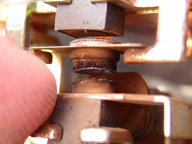

So this is how she looks....
Top
[image: top.jpg]
Left alone, the contacts touch
Opened by gently pulling down
Does this look "farked" to the expert eye(s)???  :unsure:
Spend Euro 22 on a new points assembly?
Big chance they were welded together, i do not see a smoot surface, these points are ready for the dustbin.
Spend the 22 euro's and be a happy driver again. :smile:
Ordered!  :beer:
Roukama to the rescue!
It sure does.

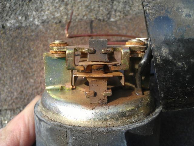

Amazed to see a lot of material left on the points. The fuel pump on my VFR stopped working because the the contact points were completely gone:
