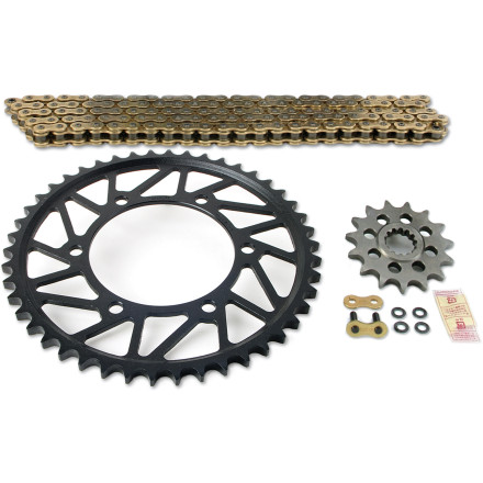

[image: X001-Y040.jpg]
Superlite 520 Sprocket And Chain Kit - Stock Gearing $270.99 $203.99 (25% off)
And  it's  cheaper  then  what  I  usually  order .

Yes Sprocket Center, the pic is generic, the sprocket will look as mine does. The 520 conversion + a galfer rotor will save you 4.5 lbs of unsprung weight, which is significant. I would suggest the DID ZVM-X chain with conversion.
