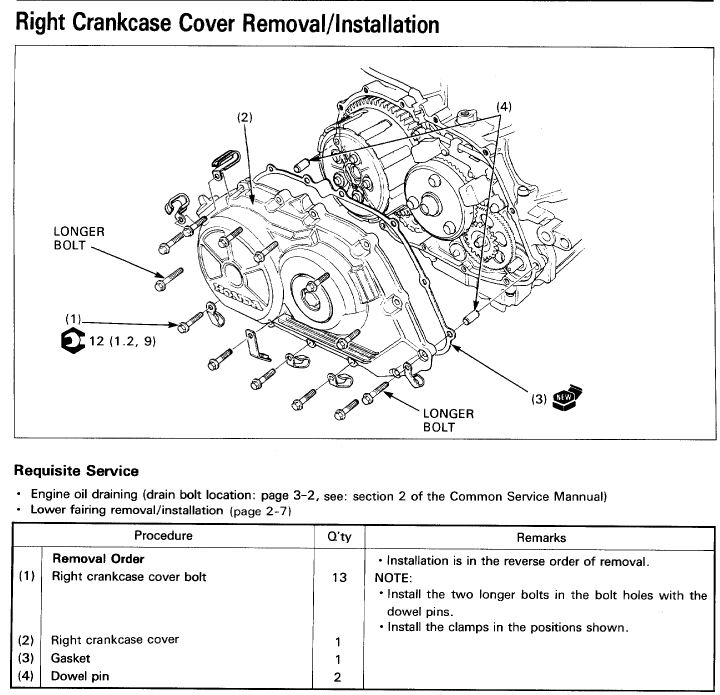

I'm a bit embarrassed that I can't find the procedure to remove/replace the clutch cover in my Honda shop manual. I've scoured the manual and its index, and come up with nothing. Perhaps this procedure is so straightforward that Honda feels it is not worth the paper and ink? It seems that removal/reinstallation of clutch cover would consist of the following:  - remove lower side cowls  - drain oil - remove clutch cover - install new cover with new gasket - tighten bolts in a crisscross pattern starting at the center of the cover - install new oil filter - add oil - reinstall lower side cowls. Can anyone help me find formal instructions for this procedure?

Hi there,
No need to drain the oil, especially if you place your bike on its side stand (in gear if the road is not level)
Here the page for the 4th gen
Thanks very much, Dutchy. I appreciate the step-by-step instructions.
