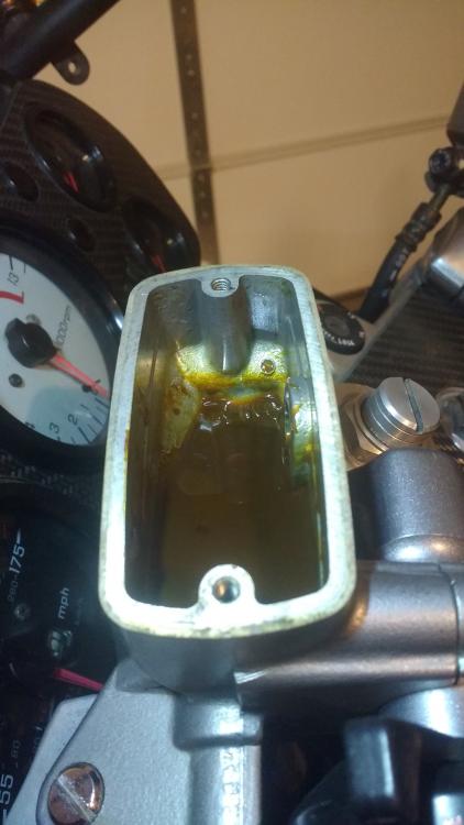

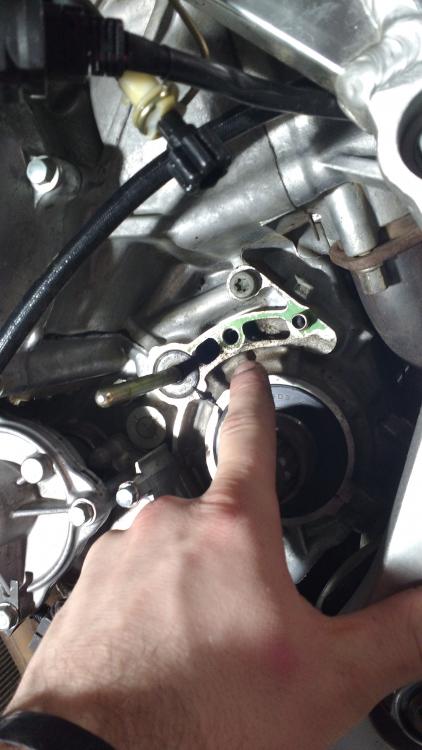

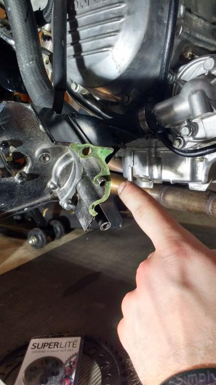

I'm changing out the sprockets on my 95 VFR and when removing the front sprocket cover i found fluid in one of the cover to case bolt holes. Initially i though that fluid may pass through but that didn't make any real sense. This is most likely just a leaky clutch slave cylinder that needs to be dealt with i think. Any input on this? I'm pointing to the center bolt hole on both sides where fluid was found.

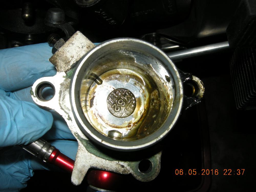

Slave on Mr.RC45 lasted from 1994 to 2012 then it was rebuilt... the MT7 part is sourced from the NR750...

Lucky guy, probably lasted due to routine maintenance. Unfortunately that's not my case, there's a chance mine had factory fluid in it still...Out of curiosity how does one remove the piston exactly? I do have a rebuild kit on standby just Incase...

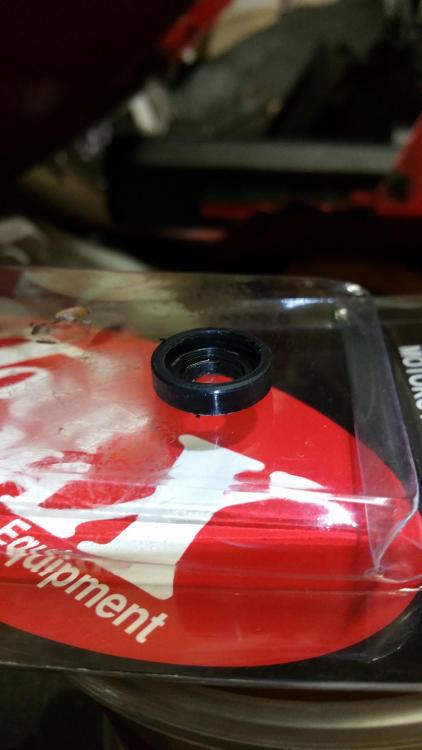

I have had the side of my clutch off, and I am not sure how I should place this washer that was in the rebuild kit. I didn't have one in there when I took it off:
There is rubber in the piston, but it doesn't want to come out the part fiche isn't very clear... is this meant to go inside the piston, or it sits outside the piston, if so which way facing the case or piston?
3 hours ago, courtuk
What's the other side look like? To be honest I never rebuilt the slave, my issues was the clutch rod hanging up so I didn't need too. That looks the the gasket that is recessed in the piston that the rod slides into.

The other side is flat. It does look like it belongs inside the piston, however my old piston that was worn, I tried to remove the rubber and it just would not come out, I eventually was digging it out with pointy tools, this doesn't seem too fit inside smoothly or with force. Although maybe if it was put inside the clutch rod it would press into the piston when actuating. I wonder if anyone else can take their slave off and see if they have this rubber piece loose inside ???

Okay, I guess the old seal is just stuck in the piston. I will try again to remove it.
