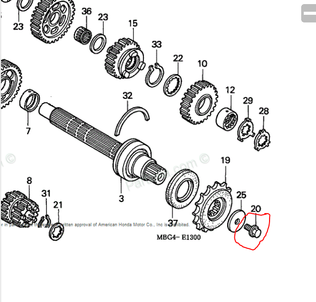

Hello, I have lurked on the forums for a while, but now I am in need of help. The front drive sprocket bolt will not budge. I have tried my air impact wrench (it's a cheap model, but I expect this would have some effect), and also long bar, but using the long bar the head is starting to round off. I tried penetrating oil but looking at the diagram I don't think it will work into the threads.
I did try to use a blow torch on to heat it but a lot of smoke came off, which is either from the chain cover, but since seeing the diagram I think I may be melting the transmission seal behind-can this seal be replaced without removing the transmission shaft?
Should I continue to heat it, or will it need to be drilled. I haven't drilled a bolt before and am worried about damaging the threads, since a new transmission shaft is costly and long repair.

Make sure you buy a new bolt.  The bolt drives the speedo sensor, so if it's rounded off it won't seat properly.

Already ordered. And also I don't want rounded bolts anywhere near my bike, just makes the next time 100x more difficult (!)
