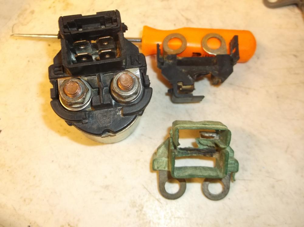

Always pull the plug atop the starter solenoid to check for melting or burning as bad connections there will reduce charging volts.
