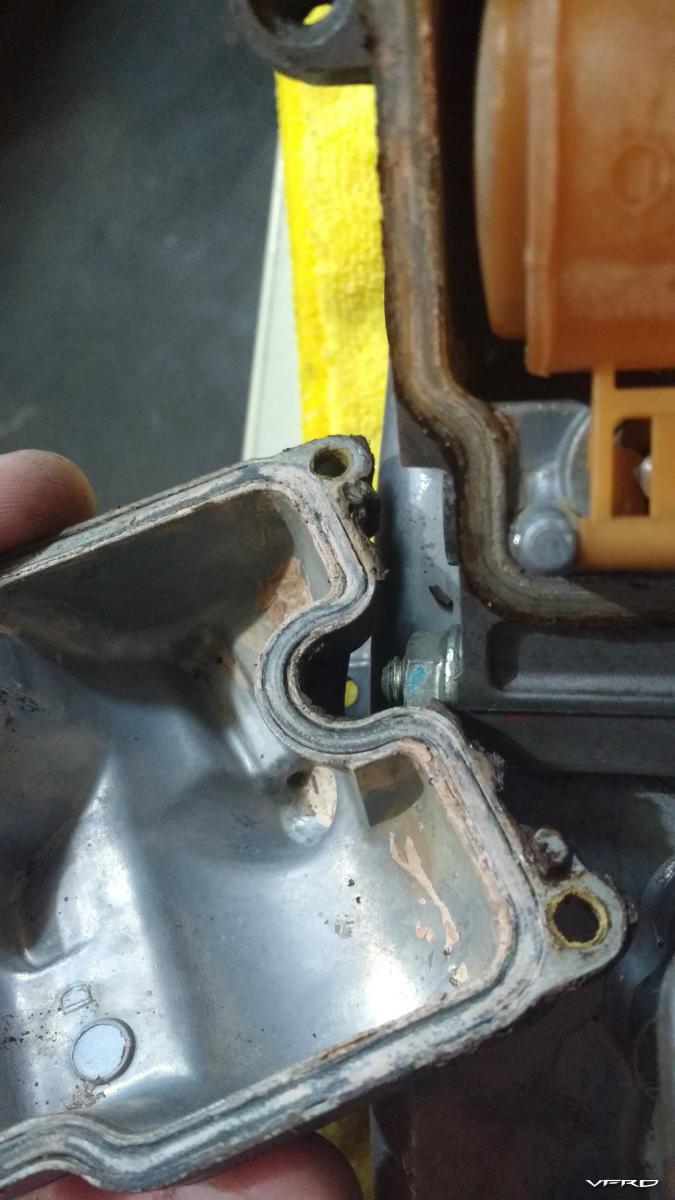

Already checked when I first got the bike, we're good on the tank thankfully. The main cause of debris in the carbs is someone used a sealant on the float bowls instead of replacing the seals. It deteriorated in the carbs and gunked everything up.

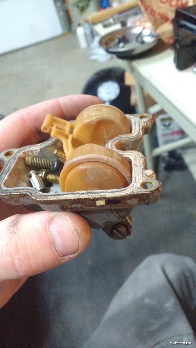

Also I have a stuck float pin that holds the float in place. I've been soaking it trying to get it to release but it will not budge, and I'm trying not to damage the needle seats. I'm about to just drill it out...any other ideas I should try first?

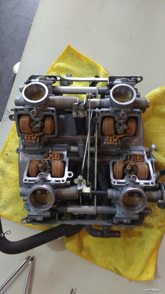

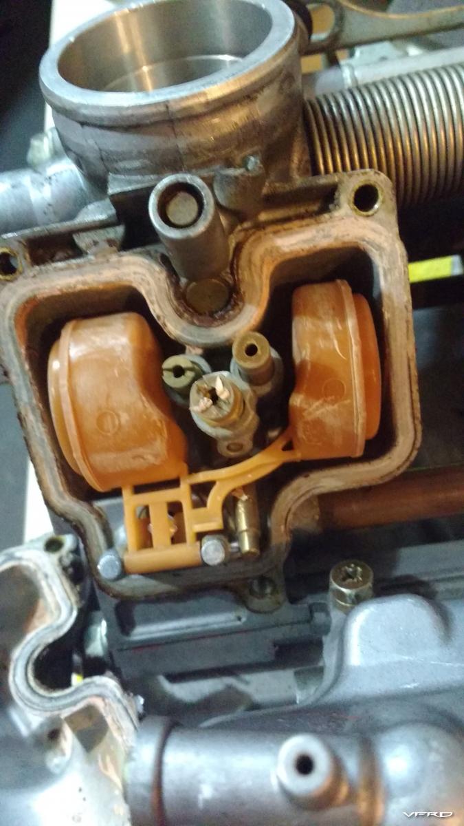

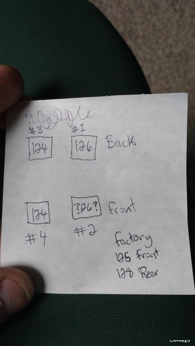

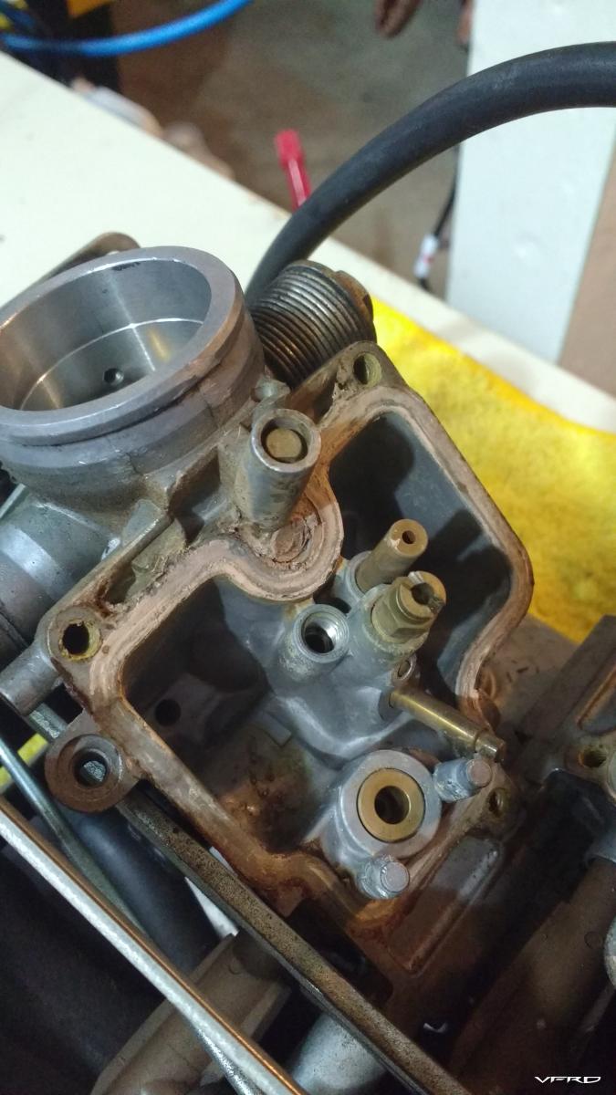

Thankfully I got the float pin out and had to do no drilling. Got everything cleaned up and blown out really nicely. I took note of my main jets size while I was in there and it seemed a little fishy. I made a little diagram that explains my current jetting. One jet is unmarked, not sure if it's factory or not? Just waiting on new seals from Honda, should be here Thursday and I can put it back together. There's a few pics to show you how thrashed everything was.large.IMG_20170511_211328138.jpg.e75d730ff4282cf4d9e1480b0d2817bb.jpglarge.IMG_20170511_211335572.jpg.c6a3caf6986ef75b8eb13b62d9d3ccb8.jpglarge.IMG_20170511_224700025.jpg.e062b72c9ba605bedff77d262c591f3e.jpglarge.IMG_20170511_224727036.jpg.ffc758a0b2e2c8fb0a340961248100e3.jpglarge.IMG_20170514_153807961.jpg.b27d9a1aec80c75b1fbf9c17637f5a7b.jpglarge.IMG_20170514_170519118.jpg.9826f3a7736b4d89951c90061d6333da.jpg
