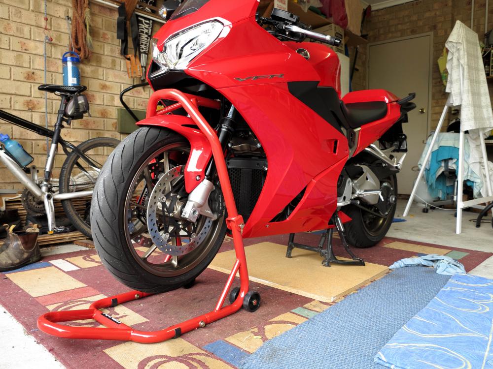

Something smilar to this:
[image: Motorcycle-Bike-Front-Stand-Headlift-Sta]
Yep, head lift stand works a treat. Placing the centre stand on approx 20mm board just gives the right amount of rear wheel clearance allowing the head lift stand to fully extend, and steady as a rock. Should work just as well for the 6th gen.

jeange, ‎18‎/‎05‎/‎2017 at 1:16 PM
Do triple tree stand work on the VFR? I don't mind purchasing one if it will allow me to do front end work and removing the wheel without hassle.

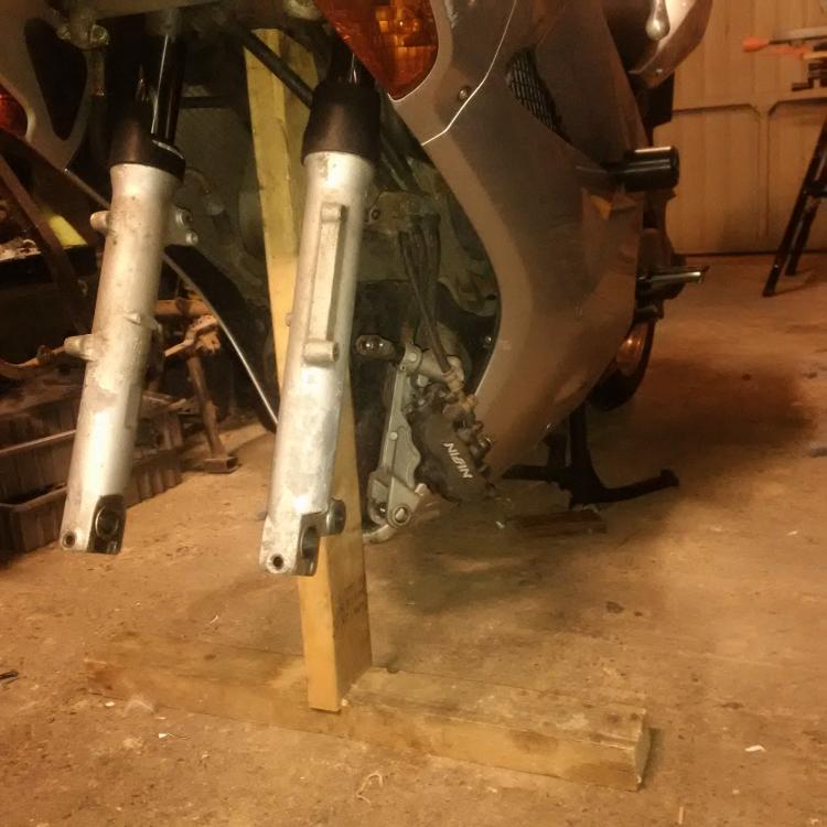

 Well mine is a little bit of back yard engineering (Red Neck Engineering!) but it worked. At the top the upright was angled to match the angle of the underside of the yoke (triple tree!) and a 14mm socket bolted on with a coach bolt.
lifted it with a trolley jack under the engine and then dropped it onto my stand once the wheel was out. Meant I could get the forks out to service and paint them.
P.S. Mine's a sixth gen
