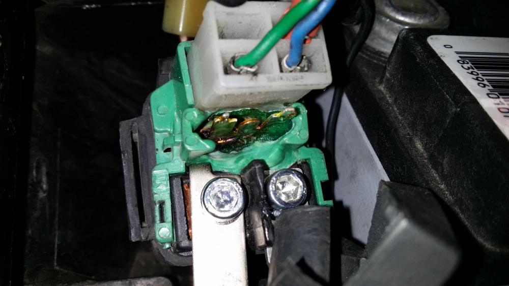

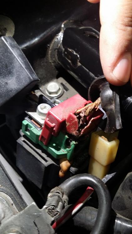

Hi thank you for replaying, well 1st time did blow a fuse, I think was cause of meltdown and cables were twisted...? 2nd time it was total meltdown and 3rd starting to melt.... pls see pics thanks,
now i just bought it exctaly 3 months ago + - idk if this was the reason it was sold.... it has power commander installed, will this have an affect/something to do with it....? Thanks again.

Hi Lago.
Your are going to need a circuit diagram. It appears you have either developed high resistance joints at the fuse or you are drawing excessive current through the Red wire which feeds your Ignition Switch. Make sure that along this Red wire no other additional wiring or services have been added as per what Lorne has suggested.
When you replace your Starter Relay, 30a fuse, and damaged wiring make sure all terminals are tight.
Might need to have a amp meter (capable of reading at least 30a) in series with the Red wire to see what current you are actually drawing.
If you had a dead short the fuse would blow immediately, having a high resistance joint or/and drawing higher than normal current is more likely in your situation.

It looks like Lago is blowing/cooking the Main Fuse A 30amp, not the Main Fuse B which is the main positive feed from the Reg/Rect.? Bit hard to tell what's going on.
Ya it's hard to tell. But that melted connection makes it difficult to ID the source of the problem. It can't hurt to clean up all the wiring.
A little bit of corrosion leads to resistance and to heat and takes out the whole connection.
