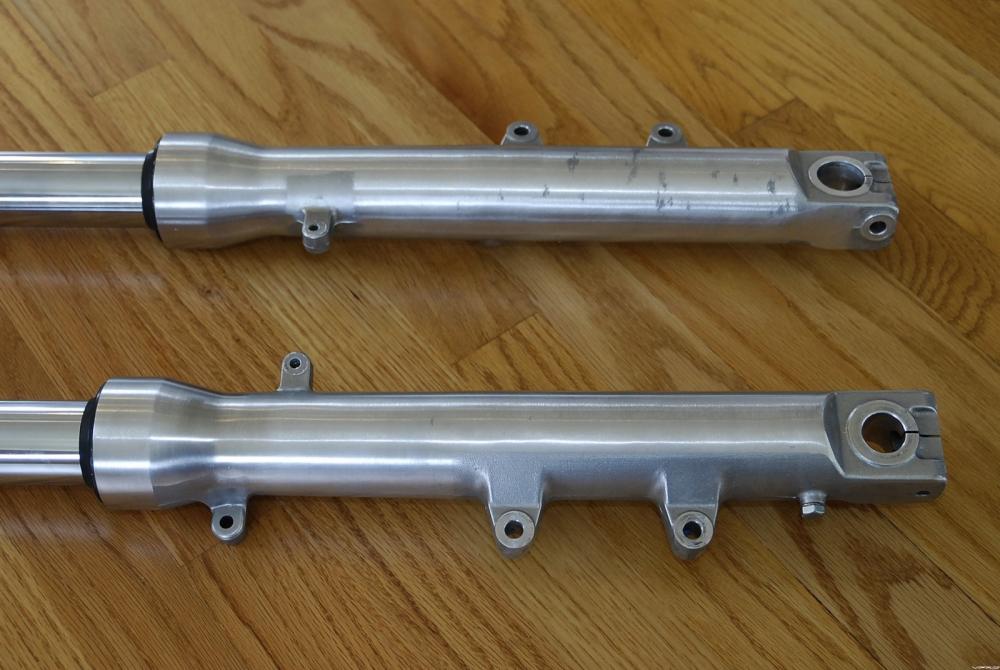

Fwiw, back '07 I stripped the yellowed and chipped clear coat from my '92 VFR's forks, then brightened them up using emery cloth for the worst areas and scotchbrite & solved autosol everywhere. Two years and 20K km later, including 3 trips to California and a track day, the finish still looked bright and shiny. I had expected the alloy to dull but was pleased that it did not.

In this pic the old clear coat is gone, and I've finished 'polishing' one leg.
Well done on polishing that fork as it looks pretty good. Initially I did want to polish it in the same way you have but I was worried about having to re-polish them once or twice every month, which wouldn't be ideal. Saying that, I'm quite keen on this route of refurbishing my ones.
