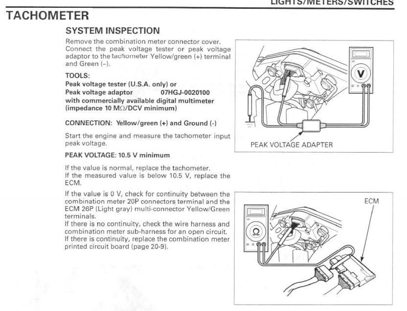

Have you noticed that your bike is hard to start or Vtec doesn't work or kick in under normal operating characteristics? If so there might be a problem with your ignition pulse generator/wiring to it. If your Vtec works as normal follow the below troubleshooting guide directly from the Honda service manual.

If you a good with a multimeter, check you have good continuity from the ECM B11 Yellow/Green wire back to the instrument panel plug. Make sure at the ECM the pin/socket for B11 is clean and good. Also make sure your instrument ground is good, however if it wasn't I would imagine there would be many other functions not working!
Failing that you may need to remove and open up the instrument panel and check for poor connections internally to the Tacho, perhaps the Tacho itself has failed.
