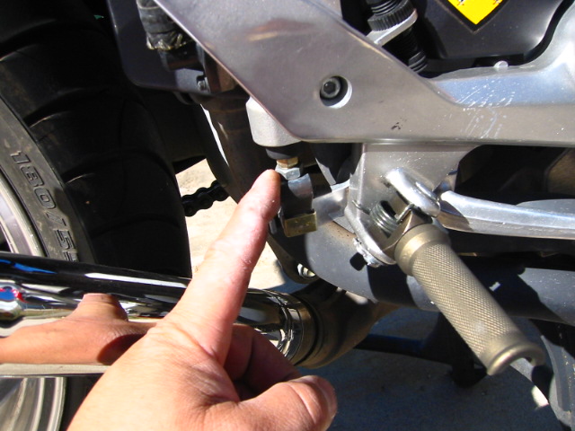

Rear Brake Lever
As you can see here my foot is flexed too far up, this is not comfortable and can lead to unnecessary fatigue or inadvertent brake pad wear.
The adjustment bolt is located in the rear of the footpeg under the brake master cylinder, it has a pinch bolt that allows limited adjustment up or down.
By turning the pinch bolt as far in as I could I lowered the brake lever by 1/2 inch, this was as far as it would go but is much better on the foot than before.

Rear Brake Lever
