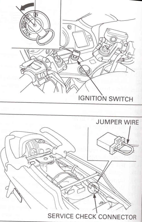

To diagnose a fuel injection problem on a 5th generation vfr with the ECM self diagnosis feature,
Begin by removing the seat, locate the ?service check connector? and you will have to find a ?jumper wire? not provided.
1. With the ignition key to off and the engine stop switch on RUN
2. Short the ?Service Check Connector?
3. Turn the ignition key to on, do not start the bike though

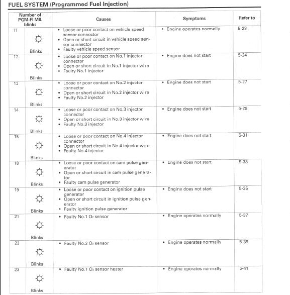

4. If the ?FI? lights up and stays on with the ignition key on then there is no memory data
5. If the ?FI? BLINKS then there is data!
Long blink = 10 short blinks
[image: codes1.jpg]
[image: codes2.jpg]

look for the blue connector on the left hand side of the rear subframe
[image: code02.jpg]
zoomed out I am indicating it with my finger
[image: code03.jpg]

My light gave two long and three short blinks, I think 'code 23'
Can I just reset the memory or should I search for the problem immediately?
