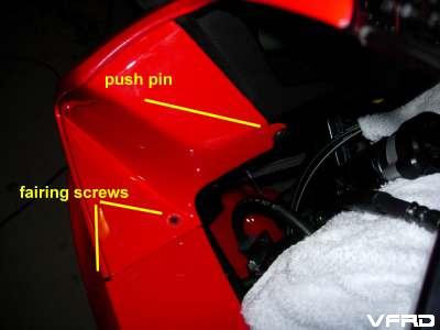

Well, I had to turn to the board to figure out how to access the headlight bulbs when I first got my VFR last month (an \'04) . So, now I know & had time to do a little picture tutorial. Hope it helps someone else. I know I was frustrated as heck at first. Begin by removing the small side panels.

You are the man, sir.
I replaced all of my bulbs about 2 months or so ago, but I don't think changing the high beams required removal of the meter panels as I did it in a the advance auto parts parking lot with no tools as I remember.
Ok, I should have indicated that this was for an "04 6th gen bike....don't know about the others! Good catch Jeremy!
Great write up!! I've been meaning to do that for a while now.
Correct me if I'm wrong but don't the tabs go behind the meter panel like on mine or is the red just different??
Yes, the tabs are supposed to go behind the meter panel

Yep they do, I need to add a shot, or see if I have one already showing that!
Nice write-up - can we move this to the HOWTO section?
Hm, I've upgraded both my lowbeams and highbeams, plus a Kisan as well, and never had to remove any meter panels... Just turn the handlebars for some room and reach in...
bsd43, Feb 14 2006, 12:30 AMHm, I've upgraded both my lowbeams and highbeams, plus a Kisan as well, and never had to remove any meter panels... Just turn the handlebars for some room and reach in...
Wished it had been that easy for me. Was no such luck. Had to take the stuff off for access. My bulbs were stuck on w/ something. Actually had to use a small pry bar.,...yeah I know you can"pinch" the sides, but it was a no go. So anyway, figured somebody might could use the pictures. Sometimes seeing is believing!

Yes...I'm sure you could squeeze in there and get them out, but it's really quite a lot easier to just remove the panel.
