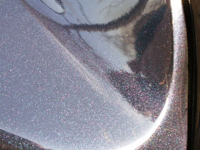

You are right, the number of coats of pearl will definately change the look of the finish, but in your case my guess is that the base color was off. I am pulling this hypothesis from the last pic, where I can see the level of metallics in the sunlight(the pearls are reflecting the sunlight in this level of light, so you see them more than you would in low light, where you look 'through' them at the base color). It looks to me like the they have their mid coat mix very close, but the base is a bit light, or 'white'. Ever notice the difference between a Ford Mustang yellow, and say, a GM Monte Carlo or Corvette yellow? I think that's what you're dealing with here. The Ford color(Lemon Ice) has more white in it, where the GM color(Performance/Sun yellow?) has more pigment and is a darker yellow. You need to start with the darker yellow, because the color will 'lighten' as you add the layer of pearls. Make sense? Hope this helps you Mike! (IMG:style_emoticons/oldemoticons/smile.gif)

Here's an example of how pearls can throw off the color of the base coat, my F4i has blue and purple pearls sprayed over black. In the areas of low light, you can see through them to the black, but otherwise the bike looks blue. Second pic is a closeup of the left air duct cover, where it meets the tank.
