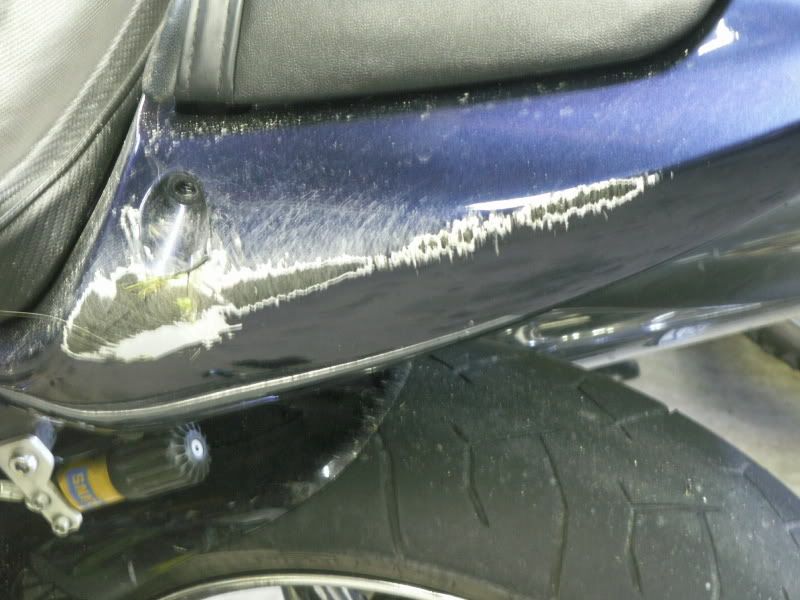

I think the worst one was the tail of my F4i. It had multiple cracks that you can kinda make out in the next pic, and the spot they were in didn't make it easier.
I had to take my time and do small spots at a time. Melt new plastic in, cool it with water/alcohol/air, then do another spot, etc. Adding the mesh backing was interesting, because it all had to be heated up uniformly to get the mesh to sit flat. I ended up backing it with some tape, and holding cardboard to the tape with my hand. Came out good though!
