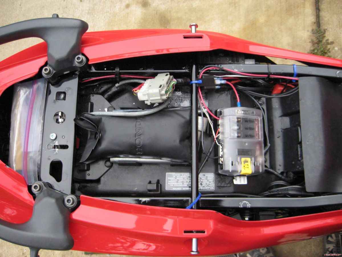

I just ordered an accessory fuse block from wire my bike. On the 5th gen, where have you all been positioning these? I have seen some pictures of placement on a 6th gen. Pictures would help if you got them, I'm a visual type :blink:

You can see mine just in front of the rear cowl cross tube. I was using this stinger marine unit for a while but have now switched to an 8 circuit blue sea unit.
The much bigger BlueSea. Also easy access to rear lic plate light for triggering the relay.

Looks good. Thanks.

Another Blue Sea Install. In addition to the fuse panel and tool kit, I also have a Power Commander in there that is hidden by the crossbar between the passenger grips in this photo.
