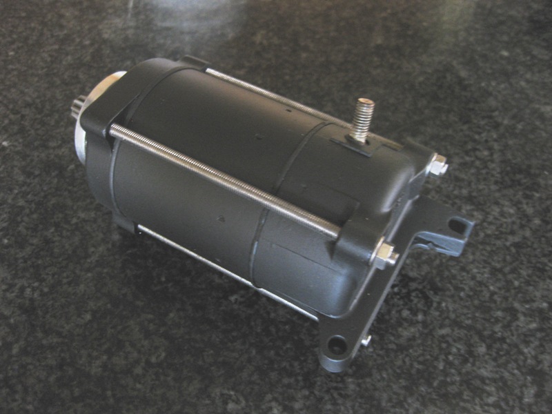

While my frame and forks are at the welders thought I�d clean up the starter motor and engine.
Sealed everything up with tape and plastic bags
Brushed on 'Gunk' Engine degreasant
Used Scotchbrite pads and wirewool on the suborn furry cases
Washed off with water
Used a dremel with various wire brush attachments to get in all the tricky places
Sprayed with PJ1 Fast Black Satin finish engine and case paint (rated to 500 Degrees)
Side cases will be removed and sprayed separately as replacing the engine bolts with socket head A4 stainless bolt kit from Ebay
Quite pleased with how it came out! :cheerleader:
Starter motor had gone very rusty so stripped and treated with rust remover. Replaced the mild steel m5 bolts with stainless threaded rod.
I have some stainless tube on order to cover the threads showing and a new o-ring before re-installation.
