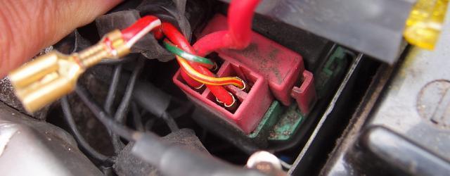

That subframe weldment photo of yours that shows the big white 3-wire stator/RR connector got me to thinking about this. You DO know about the big white 3-wire connector meltdown problems, don't you? :pissed: Maybe some folks will chime in with other common problems for this generation VFR.

I rode my 4th gen for the first 9 years without a VFRness and had no problems. I did add a heatsink from day one
[image: HPIM2330.jpg]
(chopped Pentium2 heatsink :biggrin: )
All the other wiring+plug stayed in good nick.
[image: HPIM2333.jpg]
*** Added June 2013: for those that unplugged all the wires and forgot to that note :goofy:
VFRDness red goes bottom left, where the red/white used to be
But with reading other 4th gens did suffer melting, I opted for the "better safe than sorry approach" :fing02:

hi there traveller,im on my 3rd r/r,what goes wrong is the r/r packs up and heat build up melts wiring and connectors,your running the oem r/r on standard wiring,volts for normal running is 14/15 at 5000 revs when volts start dropping ,heat for home.wet weather,jet washing vibration weakens the connections,wd oil /electric grease helps.vfrharness with finned r/r is an up grade,to oem wiring,but r/rs are very weak because of heat generated.ive done different up grade vfrness with r/ runder the seat with heat sink under the mudguard.i did a post in january. :fing02: /

- Looking at the above photo of my r/r I notice that the plug is a bit yellow. I haven't really checked the connectors but my guess is that they are going a bit south.
