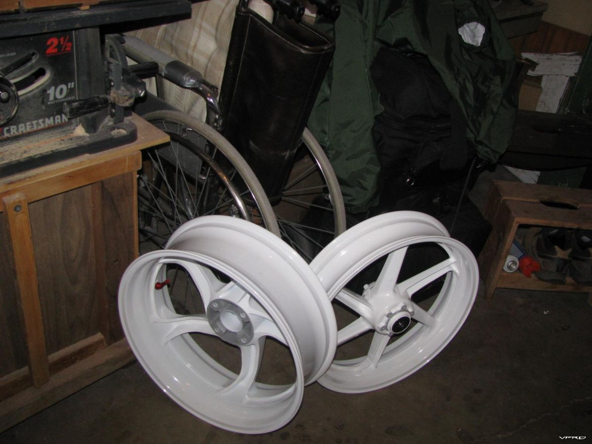

I got my wheels back from the powder coater today[image: Attached Image: 0317111435.jpg][image: Attached Image: 0317111435a.jpg][image: Attached Image: 0317111435b.jpg]
Love the white! To powdercoat, do you have to strip the existing finish or do any prep-work prior? Also, is the finish as durable as the Honda factory finish? :mellow: (Apologies if this has already been posted)
the only prep i did was remove tires,brake roters,bearings and valve stems the coater sand blasted then applied the powder.
Ouch, you have some work to do. They didn't mask off the rotor mount surfaces like they should have! Did they mask off the mounting surface of the rear wheel? This is the #1 screw-up of all powder shops(not masking rotor mounts), and the #2 problem is that they sandblast that surface before powder too!
The easiest way to remove the powder is to scrape it off with a razor blade, just be careful. You should dress it with a mill cut file as well once you have the powder off.
already took care of the mouting surface for the rotors,and no they didnt mask off the mouting surface for the rear wheel.even thu i told them to do both,wich is the only complaints i have but at least they didnt sand blast the wheels
Just wondering, what is wrong with sand blasting the wheels?
Nothing wrong with sandblasting the wheels. I have a problem with them sandblasting the rotor mounting surface! And/or the bearing seats, and/or whatever else these inexperienced clowns forget to do. Nothing like getting a set of wheels back only to find half your rotor bolt threads gone due to some $5/hr clown not taping them off and just blasting away at your wheels! Nevermind that it's a machined surface with a profile tolerance...

For sure. Can't exactly leave it there either. Did you let the powder shop know that they screwed up? Even if they don't try to make u pfor it, it may at least save the next guy some pain.
#1 most common screw up maybe, but #1 worst screw up is powder coating the inner fork clamp surface of a set of triples and explaining 'that's how we do all of them'..... :computer-noworky:
