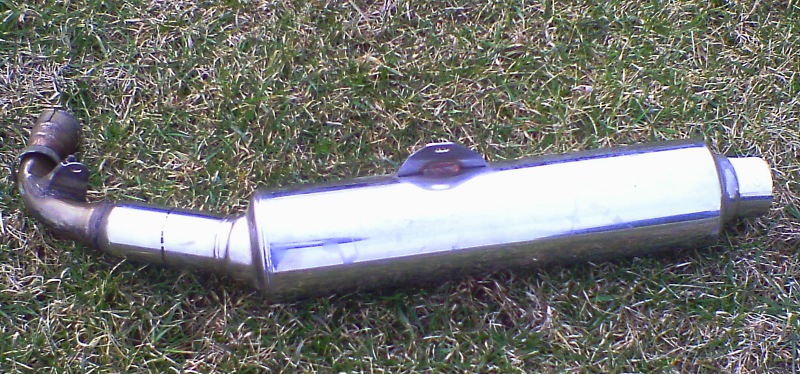

I had to cut off some of the nose of the new muffler and weld the end of the exhaust pipe stub onto the muffler.
Here is what the left one looked like when I got it.
There is a black line on the front chrome part to mark where I am cut it off. The end of the pipe was salvaged and it fit over the stock header, The muffler fit over the stub. Not much goes to waste. I slipped on the front stub and bolted the muffler on the bike and put a couple of tack welds. I then welded across the front of it to seal it up. I coated the fresh area with some Eastwood Stainless steel coating

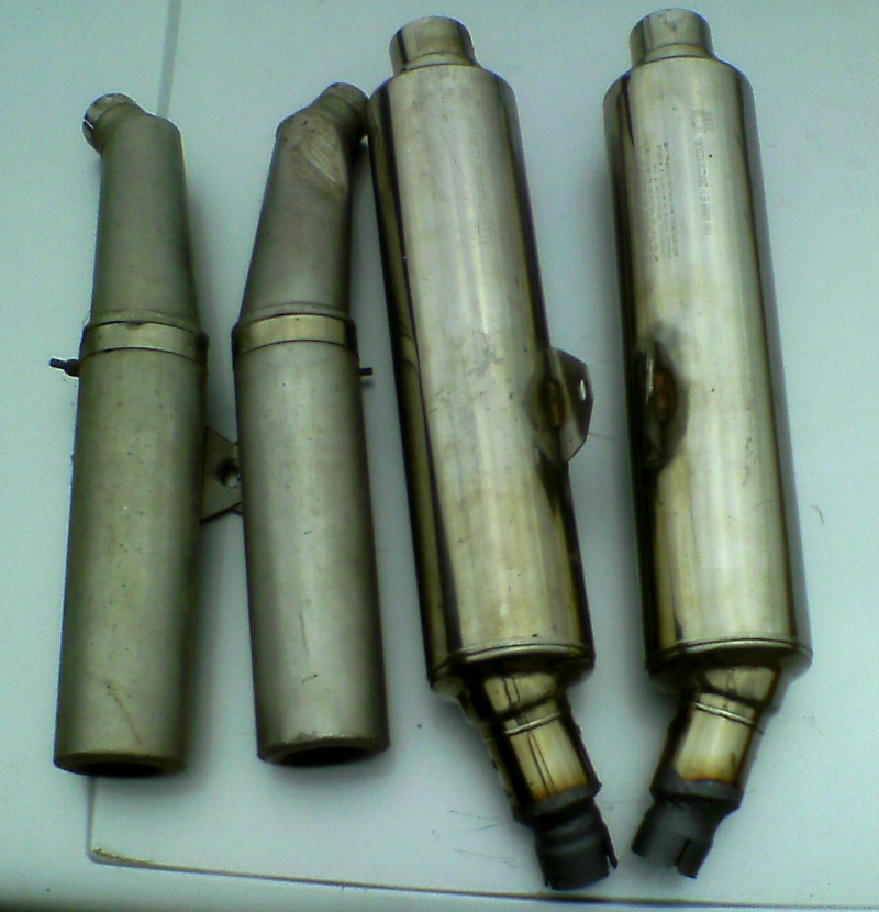

This is what the original pipes looked like, (are they Formula slipons?) and the new mufflers.

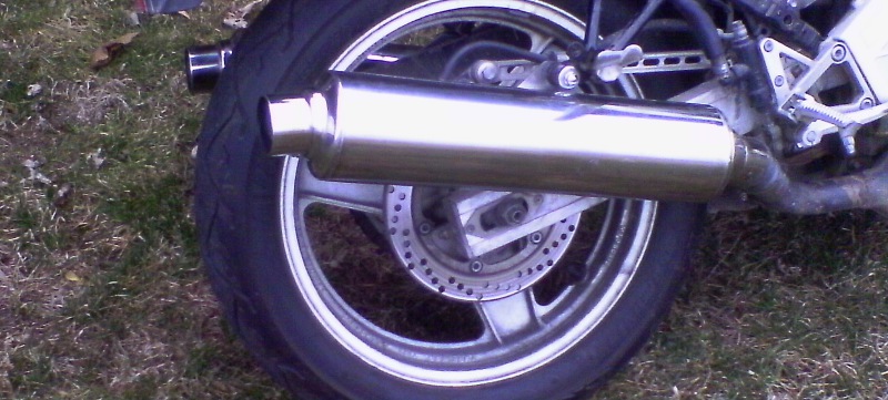

I still have a lot to do to get my bike road ready but I did take it up and down the road,,,,Nice smooth and torquey.
