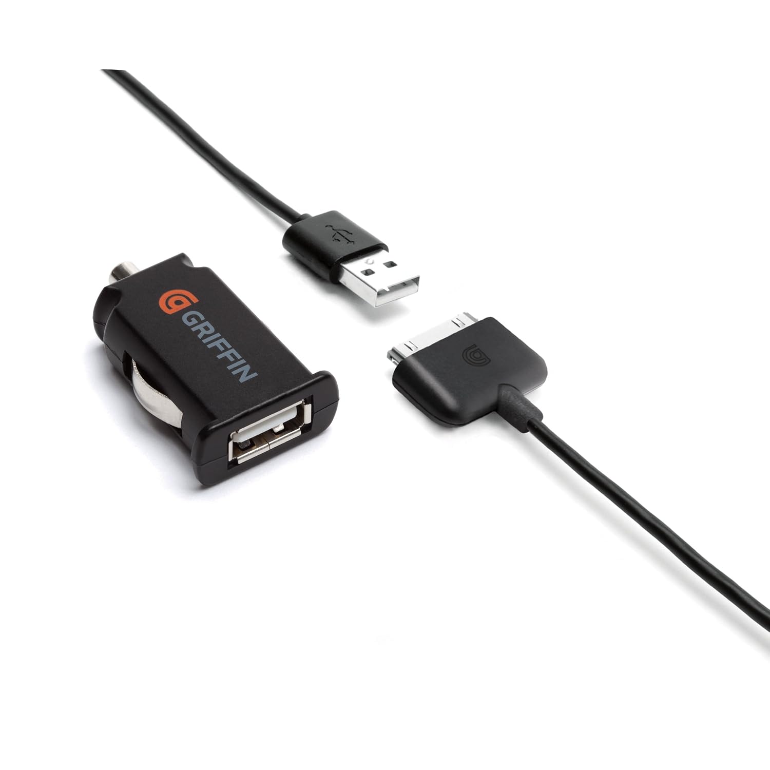

I cannibalized a very small cigarette socket-USB unit for my recent tank-mounted electronics project.  It was a Griffin PowerJolt, with a 2A output.  Stick a standard mini-USB cable in there and you're done.

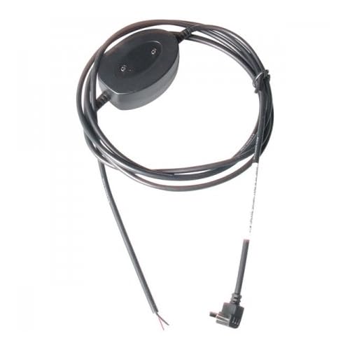

[image: View Post]wera803, on 22 March 2012 - 10:08 AM, said:
I've used one of these before for a GPS. You can put an SAE end on the wires if you want, or go directly to the battery.
http://www.amazon.co...s00_i00_details
[image: View Post]NorthernVFRDave, on 22 March 2012 - 10:00 PM, said:
That's what I've been looking for, thanks for the link.
