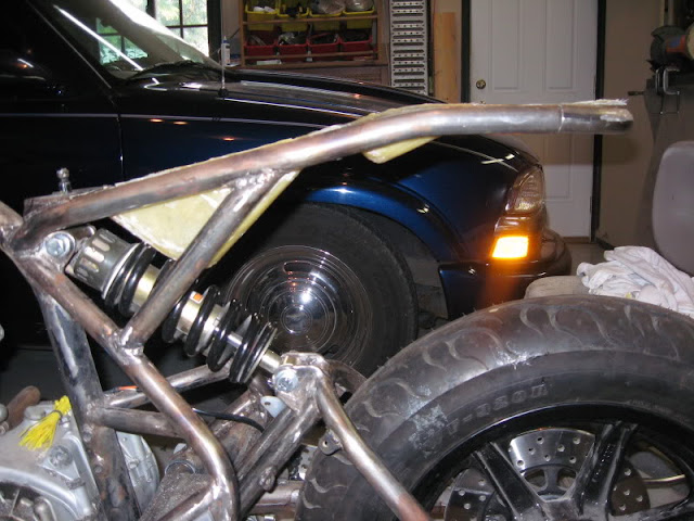

From the side view, look from the gas tank to the shock mount. It goes down hill then right back up. Most of the bikes you showed photos of, have a little filler piece in there. It isnt impossible by any meant, it just makes it harder.

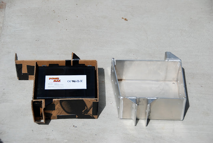

Well, I got the point Timmy and enuf talking abt. Btw, I prefer to replace the OEM airfilter with the smaller aftermarket filter and make the box underneath the seat to be clear. Jus like this one:
However, I wondering where to put the battery. Someone make a battery box right under the engine. I think they also do so for the bike above. But how to make it easy for removal, maintenance, etc.. I hv no Idea though.
I also did called and emailed someone who selling CX650/500 with reasonable price in LA and nearby... but not good result up to now.
Oh, they have detail discussion here: http://www.dotheton....hp?topic=9063.0 ; http://www.dotheton....?topic=13231.20

Is that really that great of an idea, to put the battery at the bottom of engine where it will get lots of road debris and heat from the engine? It will get some air cooling, but still.
Someone locate the battery right under the seat:
Quite good place to hide the battery, and that's even better as people pay more attention on the cocktail tool:

[image: View Post]VietHorse, on 20 February 2012 - 01:55 AM, said:
- Looking for small size with suitable capacity battery. An Ultrabat is quite small and you can use it in any orientation, unlike a lead acid battery.
There are others, like Moty, Shorai or custom battery packs.

Here are some examples of single rear sock modification.
The same BMW bike as above (made by sparkymoto - ADV):
Here is another one - Yamaha XS650:
Those pics make me to decide of making monoshock.
Now is how to make it right.
I know mountain bicycles use mono shocks in a direct configuration... Obviously these have very reduced shock travel compared to a motorcycle, just curious how this might apply in this situation.
The direct configuration of rear mono sock will make the shock very stiff.
I may try to install the suspension linkage to make it works smoothly; but  don't know It has enough room for the linkage or not.

I know mountain bicycles use mono shocks in a direct configuration Motorcycles too, like the Aprilia Shiver and Ducati Panigale (well almost direct). But like vfrcapn and veefer800canuck mention you need a shock that matches this configuration. Revalving & respringing will most lilley be necessary.  A link system makes the suspension very progressive, the direct configuration is almost linear sometime even slightly regressive.
From a communication with the owner of above BMW cafe racer, he has given me a lot of useful information, especially for the monoshock make.
Really supportive and very informative guy.
Here is his reference for the Sub-frame making and monoshock configuration - Ducati SS 1999.
That's really good source for consideration.
I am thinking of choosing either welding or bolting subframe.
That's called "Monoshock, older style, regular swingarm"
Quote
In 1977, the first monoshock system appeared to niche markets and racers. It has actually been around in one form or another since the 1930's, but it was only in the early 80's that monoshocks started to appear on production bikes. Monoshock is actually a Yamaha trademark, but it has become synonymous with the design in the same way as people in the UK refer to vacuum cleaners as hoovers. (The Honda version is called Pro-Link). The premise was that manufacturers could save some weight by redesigning the rear suspension and removing one of the coilover units. Monoshocks are still coilovers, but there's only one and it's mounted centrally to the swingarm. On earlier models, the rear swingarm was a sort of basket with a linkage at the top-front. The monoshock sat nearly horizontal in the bike.
[image: View Post]VietHorse, on 28 April 2012 - 10:13 AM, said:
A simple example of suspension linkage:
Yes, but this kind of linkage has a different purpose, it is to keep the damper from being lateraly loaded.
