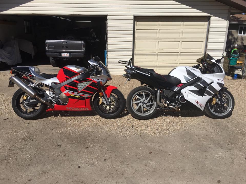

let the modding commence
bought so far:
[image: 18268215_10155393325043470_8944832437526011567_n.jpg]
On the hunt for some stock CBR1000RR wheels in gold......

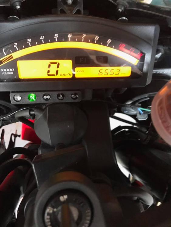

Thanks Lorne, it's a 2001 SP1
actual odometer reading.
IT STILL HAS THE ORIGINAL REAR TIRE FROM 2001! Front is brand new, 0 miles, but 10 years old!
(yes, I'm getting new tires)

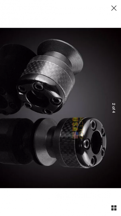

Bought a rear Pitbull and front Woodcraft stand for the RC, and a set of swingarm spools.

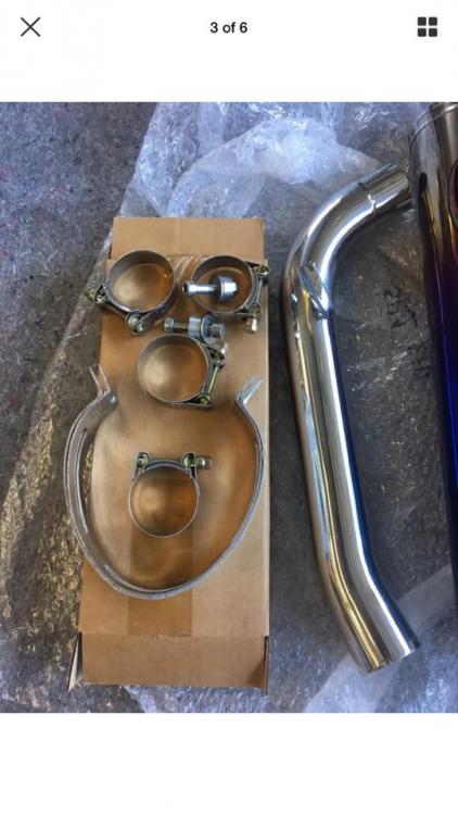

Mounted the exhaust the other day.

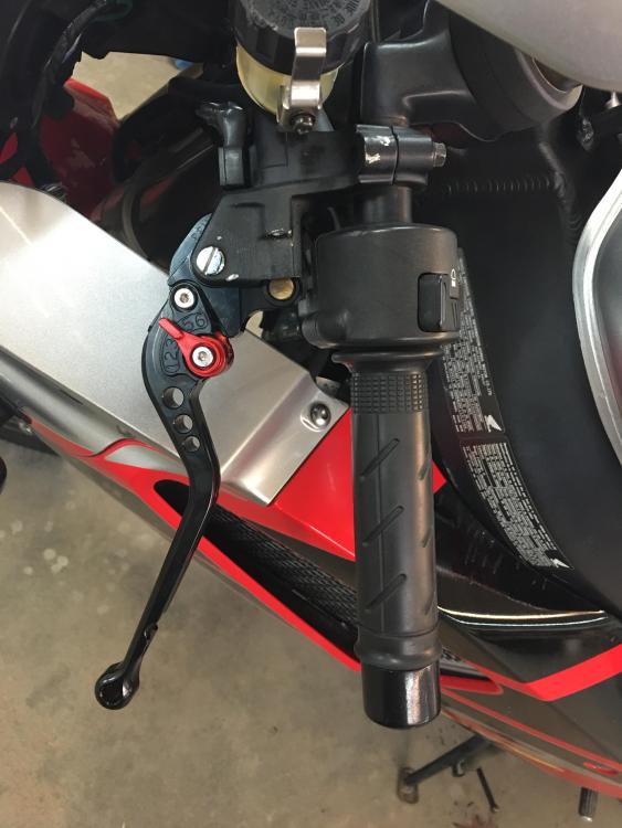

Installed the dubious Chinese levers

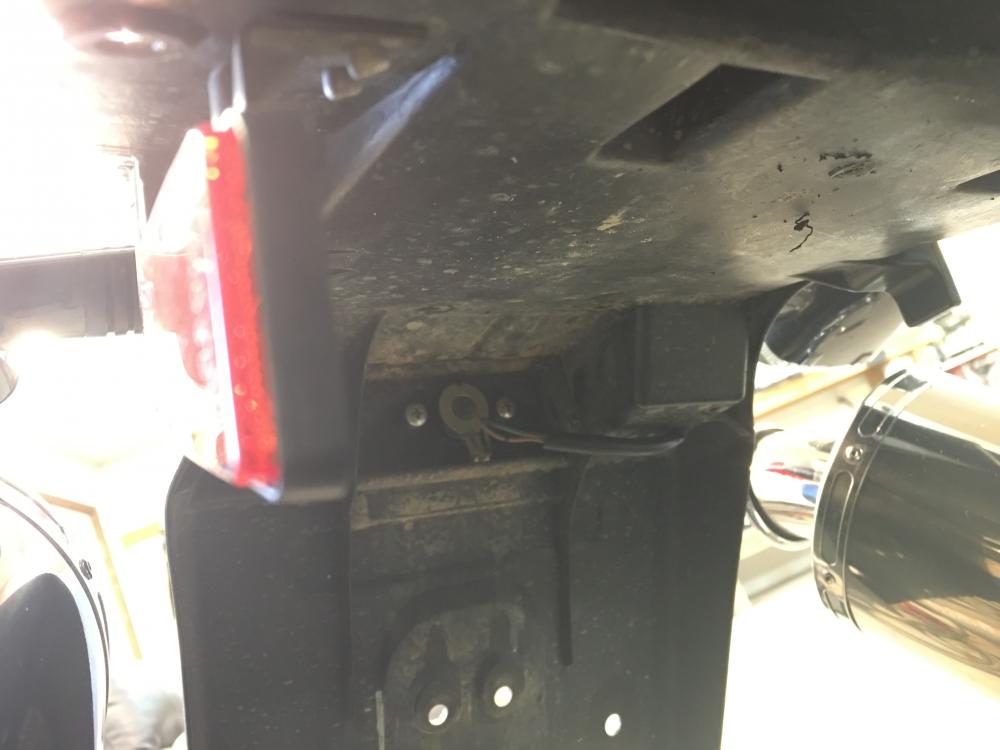

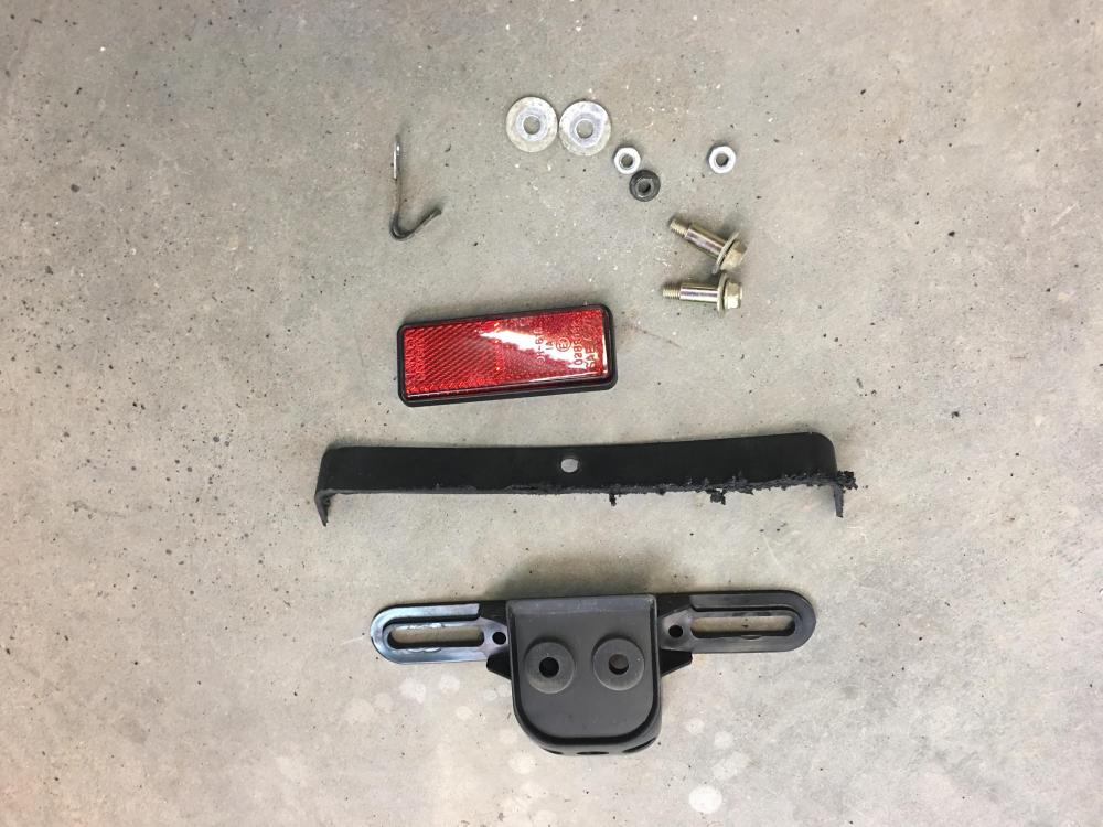

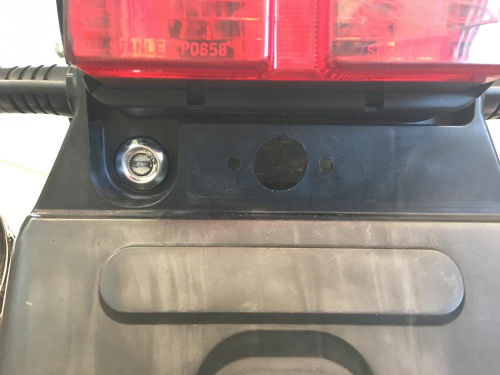

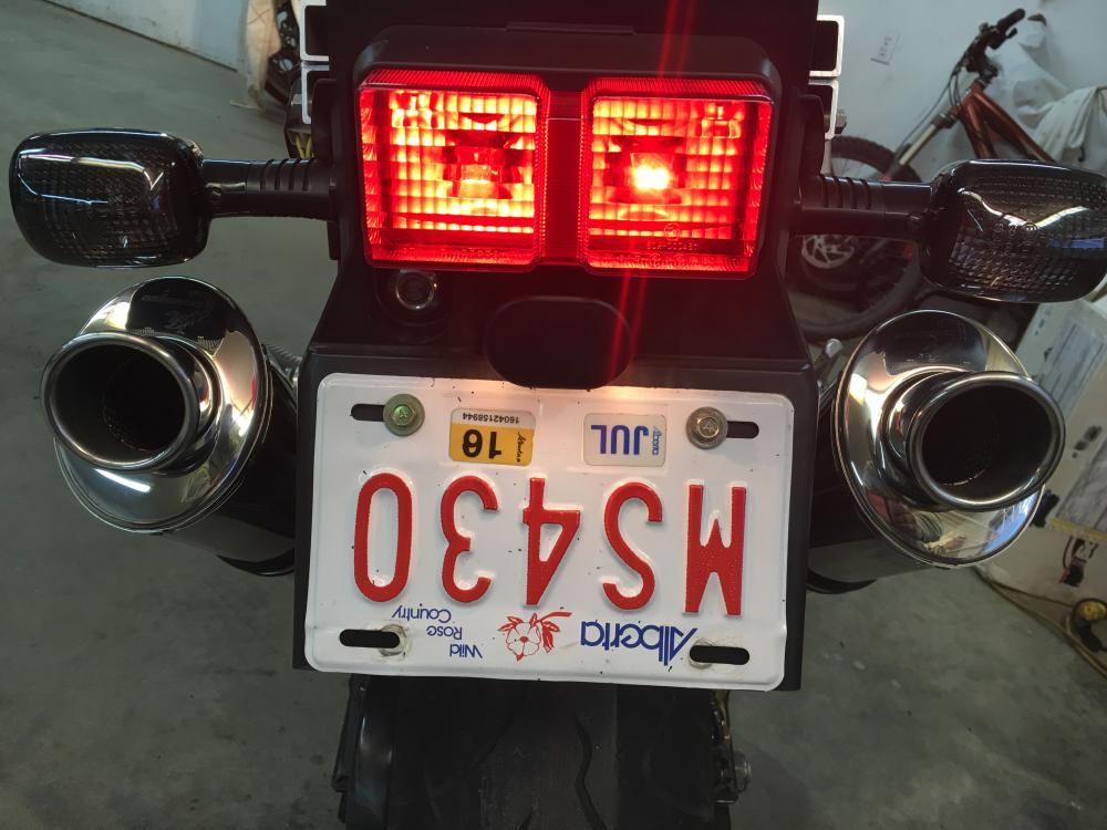

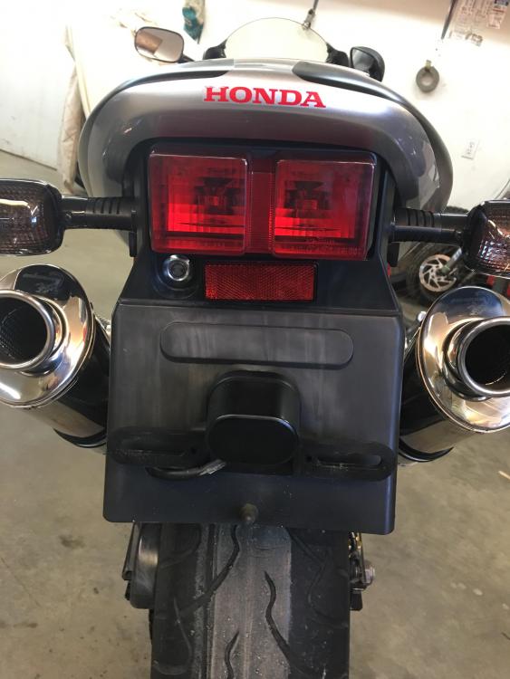

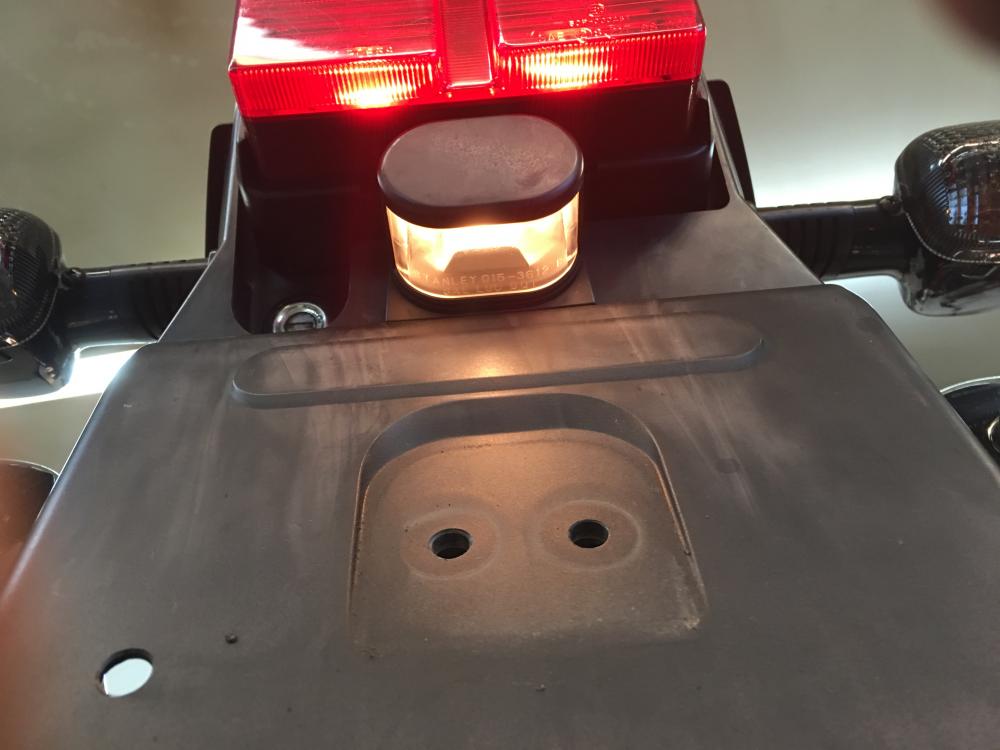

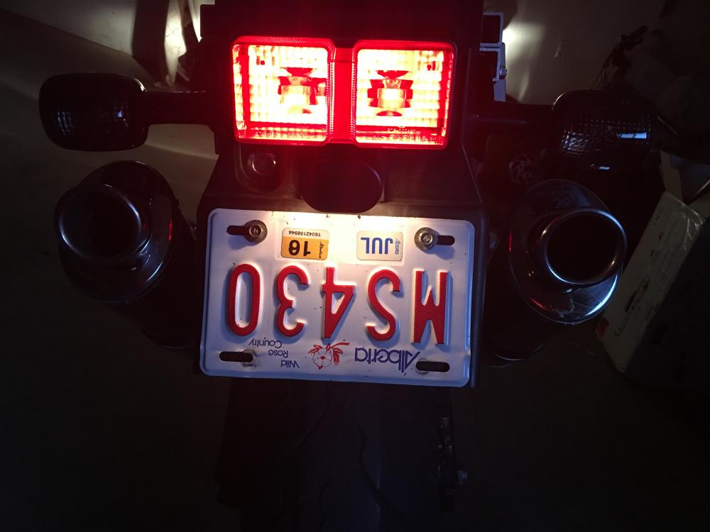

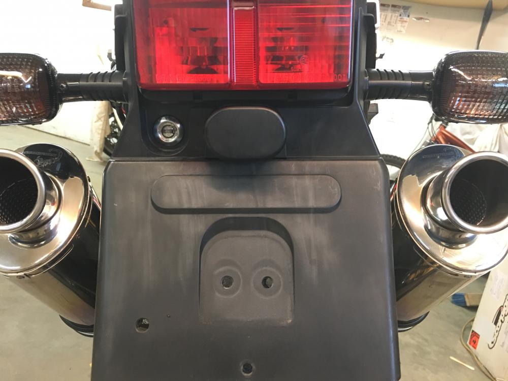

Modded the license plate mount and light:
Good on you for figuring a way to tidy the license plate lamp/mount. On my Gen5 & VTR1000F I just removed and put 'em on a shelf.
Did you bolt the plate directly to the mudguard? If so, a sheet of rubber (truck tire inner tube, for eg.) as a backing dampens vibration and should prevent the plate from cracking.

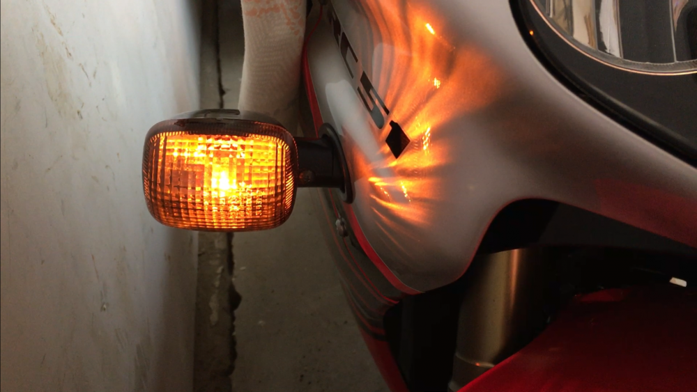

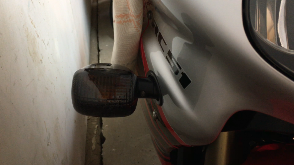

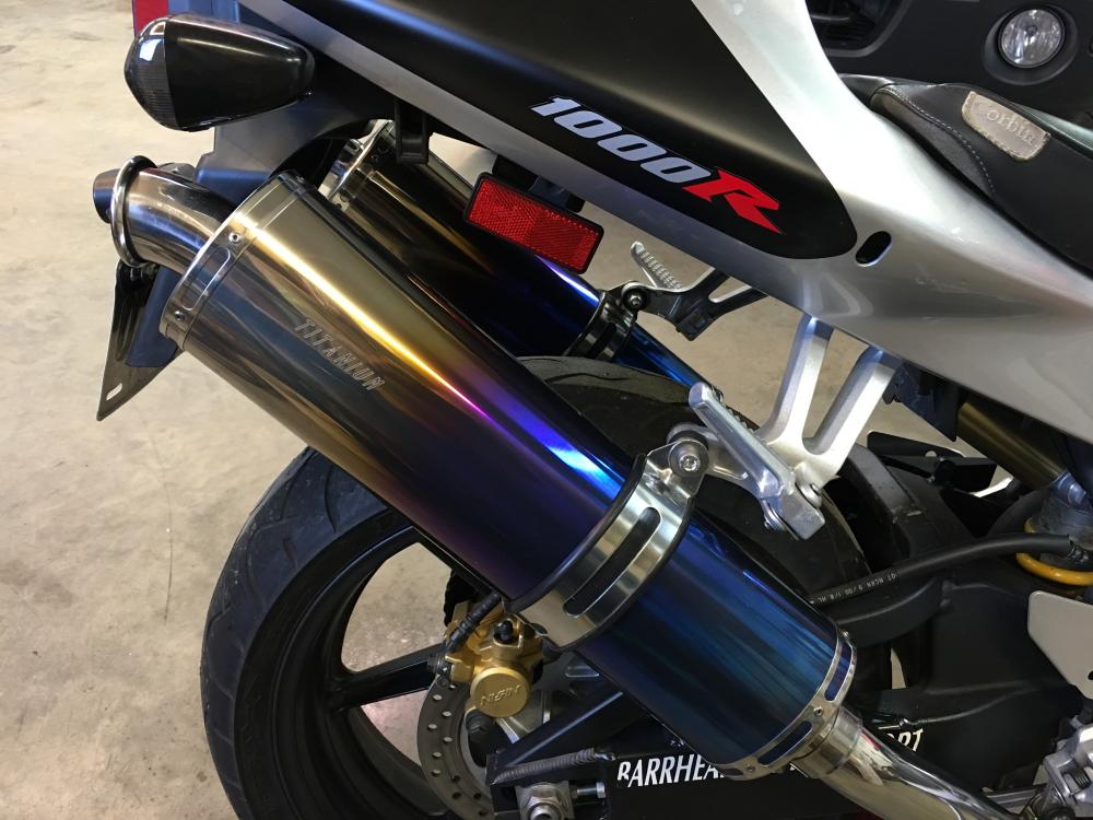

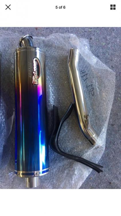

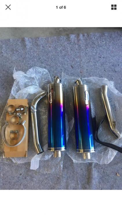

Scorpions are on, they sound wonderful.

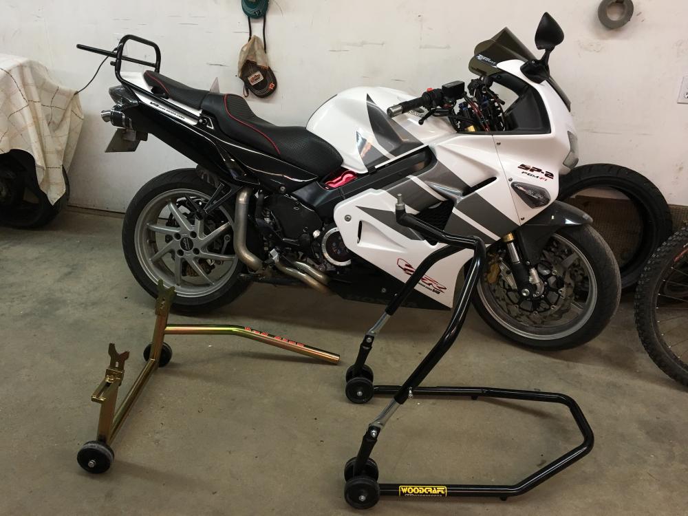

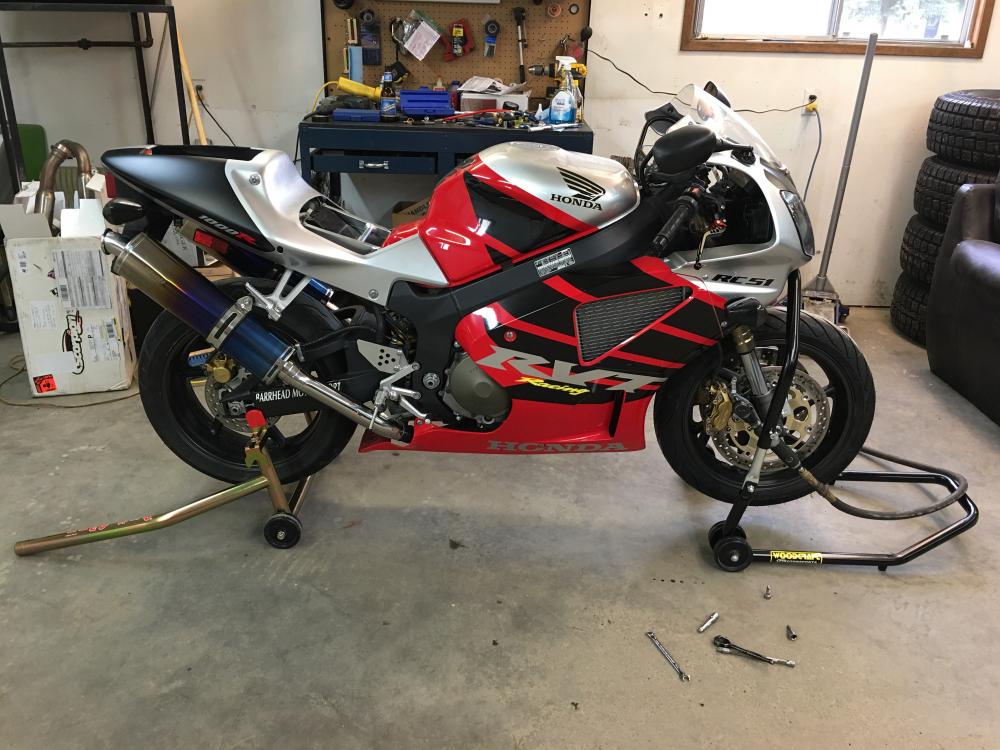

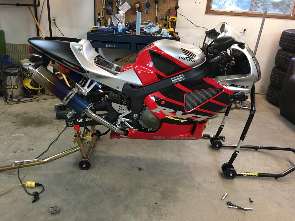

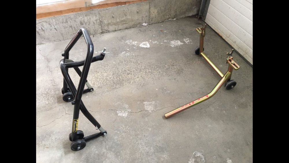

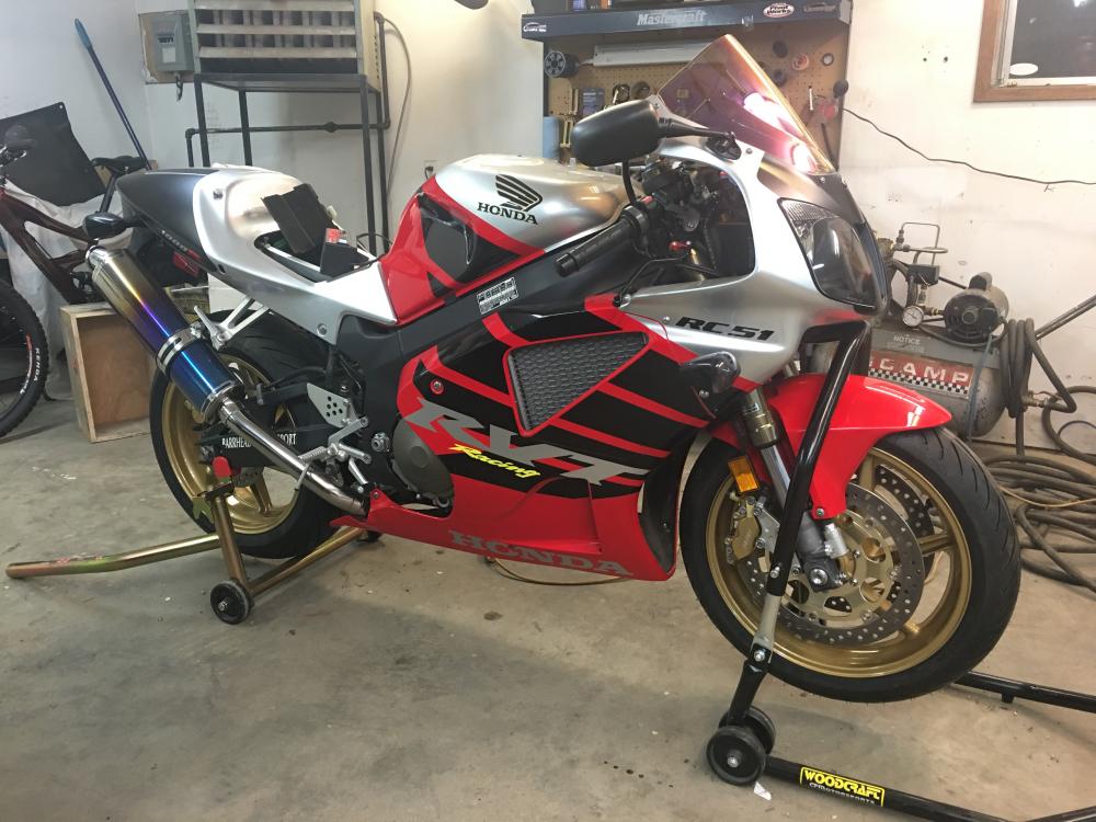

Got some front and rear stands for the RC
The rescue project is ramping up, as time allows.

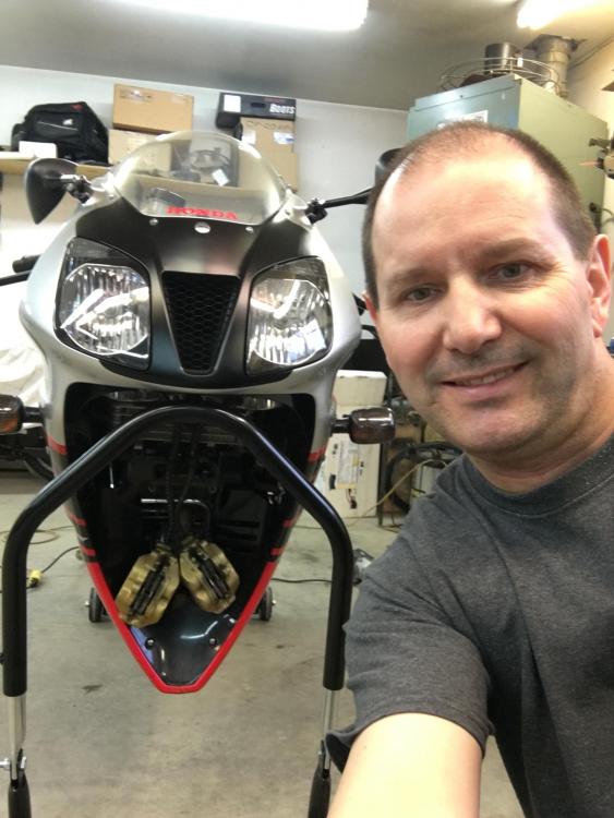

instead of mowing my lawn, I tore the RC apart.
Wheels off, to be powdercoated gold, and forks off for new seals.
The gold wheels pic is just for reference, that's the shade I'm shooting for.

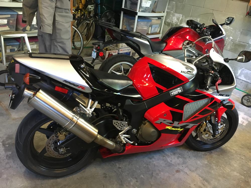

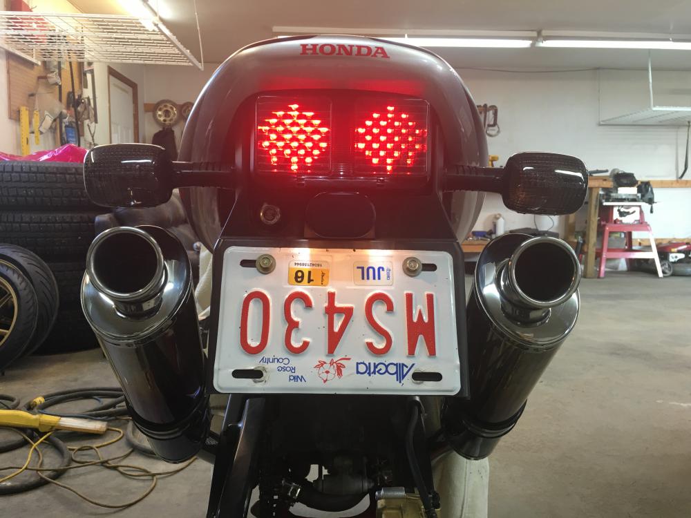

Dubious Chinese windscreen installed.
Fit perfect, first try!

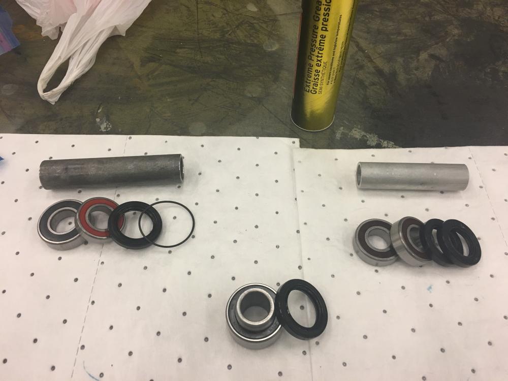

Wheel bearings have been cleaned and repacked with fresh grease.
RC51 heads over on FB were all like: Just buy new bearings man!
And I was like: Naw, I'm good, thanks.
$7 worth of grease and a little time and they're mint!
With only 4,000 miles, they'd better be!

Looks good, are you keeping those Indicators? is there any local legislation that prevents you using surface mounted indicators.. they stick out like my brothers ears! :goofy:
Woodie, 2017-07-06 at 5:38 AM
I don't like the flushmounts.
We're invisible to cars as-is!!!
+1
One of the 1st things I did to mine was getting rid of the flush ones, back to OEM.
An OEM tail will cross the Atlantic so I can fit an OEM rearlight (aka breadbox) and OEM indicators.

Well, 4.000mi plus whatever you did to get them out... Bearings are usually installed using the outer race, which puts no stress on the balls and inner race.  But bearings are usually removed by exerting force on the inner race, which does.
Fair point. Although I like them as they show up from the sides as well as from the front.

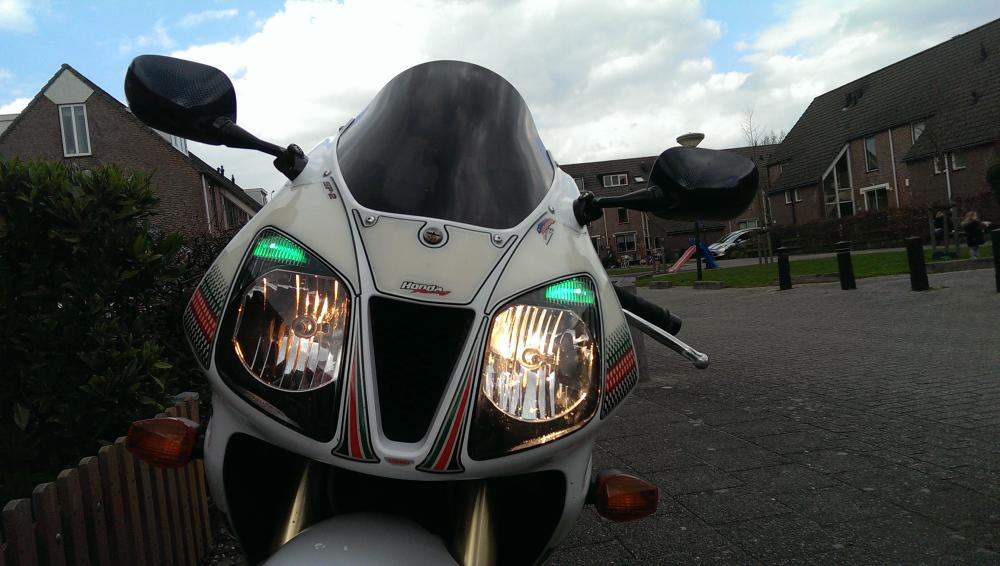

The one thing has worked biggest for being seen, for me, has been LED lights, especially the aux LEDs I fitted to the Crossrunner.
I know aux lights probably wouldn't work so well on an RC51, but fitting replacement headlight bulbs, whether bi-xenon or LED, would be worth considering imo, if you're not already doing that.
Just a thought.....beautiful bike btw. :beer:
Twin yellow headlights, Led dlrl and running lights
medium.IMG_9607.JPG.ab3fbb74128130427f1cacd5ad2cd963_1.jpg.598c27c0b23d3c7854238e3f16db1d63.jpg

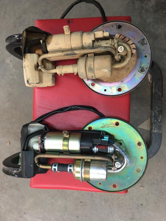

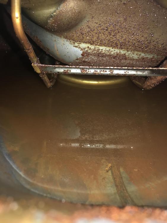

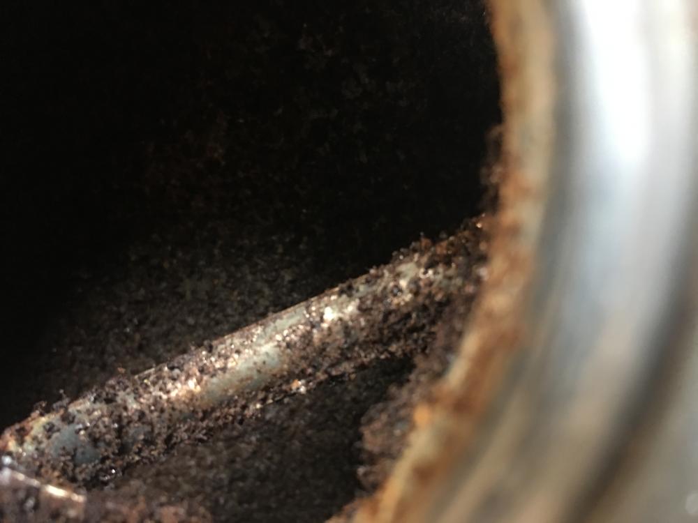

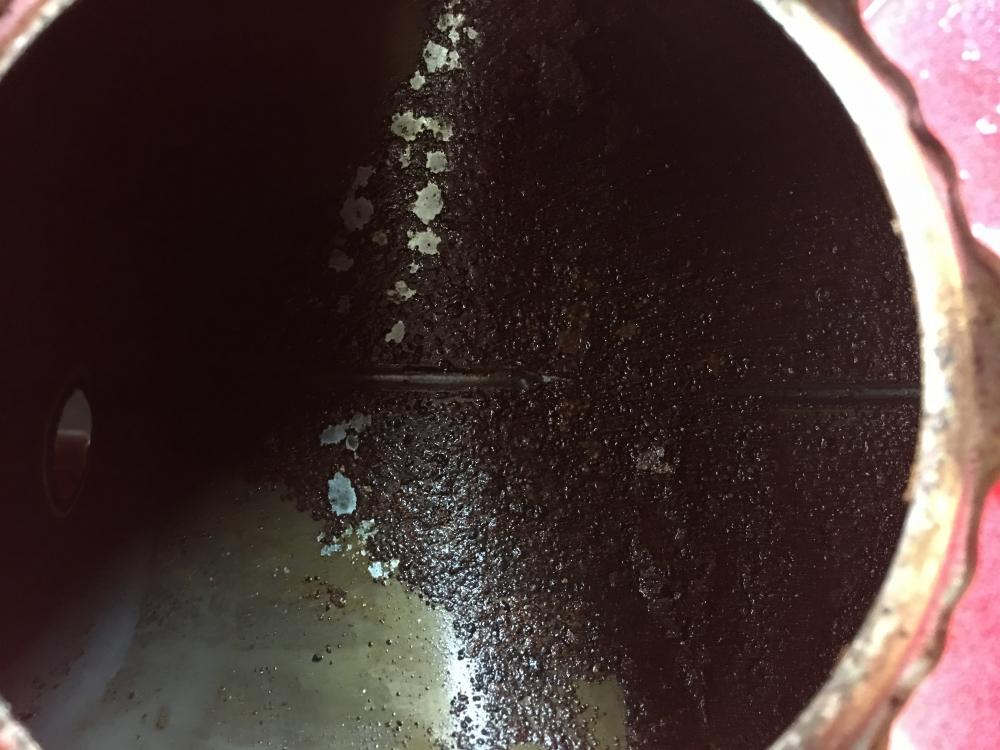

Now to clean the chain, change the front sprocket (-1 tooth), install the speedohealer, and clean the dreadedrusty fuel tank.

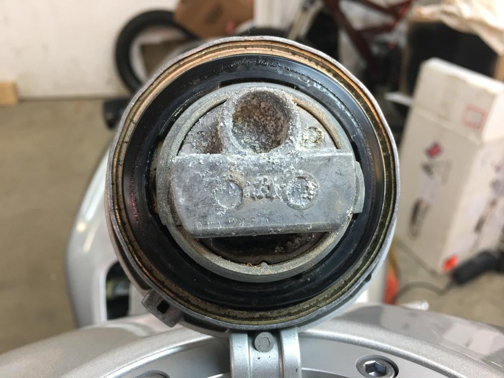

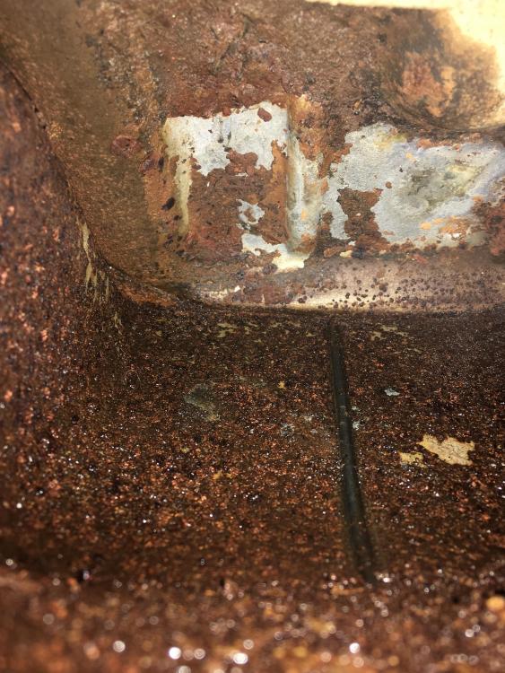

Ruh roh, hope everything downstream of the tank is ok - primarily the injectors.
Any thoughts n how the tank got in such a state?
20 hours ago, Lorne
10 years of being parked with ethanol fuel in the tank.
The bike ran PERFECTLY before I took the tank off, started immediately, revved perfectly, idles perfectly, etc.
I had ridden it home like 10km when I bought it and it pulled like a freight train.
I removed rhe FPR and blew out the entire fuel rail and HP supply hose with compressed air. NO RUST came out. None.
I also blew the FPR clean, and there was only a speck or two of soft debris in there.
OE fuel filter must have worked!
Guess which of the two fuel pumps I'm putting back in??

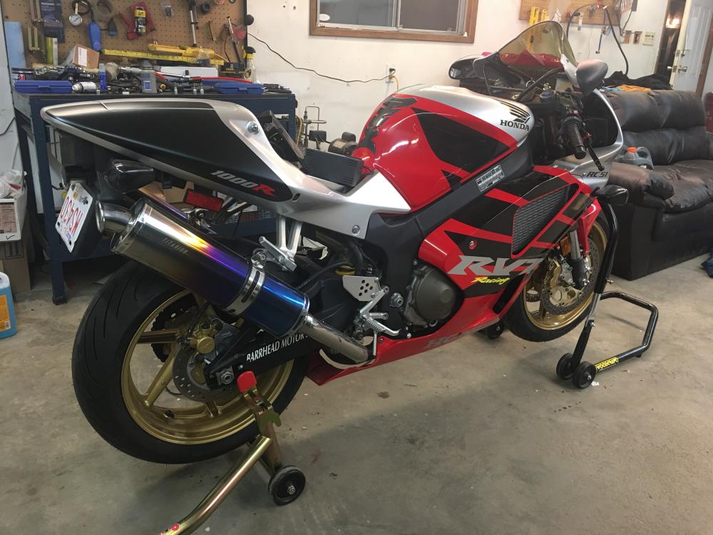

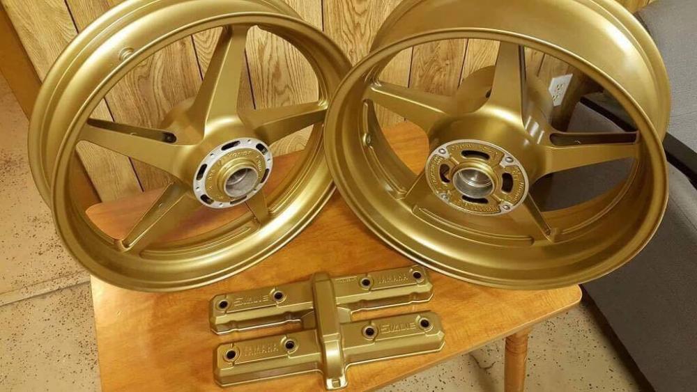

It finally happened! I powdercoated the wheels at work, and they came out nice. All new wheel bearings, seals, brake rotors and tires. I know it's not pristine, but it has all the tasty bits I wanted. Having so much fun riding it, I don't know if I will go back to the clip-ons.............just have a few pieces of bodywork, and new headlights to replace the old.
the RC Tuono!

Managed to blast the fuel tank innards at the car wash to get most of the loose rusty scale out.
Bemoeve it or not, the pic is an improvement over what was before!!!
Dried it and now trying to find time to do the tank cleaning and coating kit.

All I had to do was clean and coat the rusty fuel tank (already taken off and washed/aired out) and install/size the new drive chain.

-Smoked turnsignals and smoked LED taillight

-Rear fender trim and license plate light relocate/bracket removal

PAIR valve elimination, totally removed all PAIR components, not just plugged off.
[image: D53C3F11-B5F3-442A-9C58-448D66A80FC5.jpeg]
[image: 6C7918DE-2B05-4DF5-8E85-5F456C7E1AE1.jpeg]
So while I had the airbox off to do the PAIR removal, I thought I’d go the extra mile and pull the injectors, due to the fact that my fuel system was so gacked up from being parked for 10 years by the PO. (BADLY rusted fuel tank)
Three injectors came out fine, but the rear injector on the front cylinder left some crumbly black debris on the throttle body when it came off.
Looking closely at the injector, what remained of the OEM bottom seal was destroyed, and it looks like someone put a generic O-ring on there which is smaller than the others, also, the remaining 3 appear to be square in profile and not round.
Boy am I glad I removed all of this stuff and checked!!!
Next stop: professional injector cleaning and new seals.

Lorne, I’m trying to clean the tank, I did a vinegar and nuts/bolts wash and shake, over the course of a week, changing the vinegar out every 2 days.
I rinsed the tank probably 12x with water after that and I’ve gotten the majority of the rust out.
Im going to use the tank coating kit I got with the bike next, using all 3 steps now that the tank is 97% rust free.
The brand new OEM tank is coming from Japan, I just don’t know when.
Once the new tank arrives, I’ll be selling the old one off to help offset the cost.
A week’s worth of vinegar, a handful of loose nuts and bolts and shake shake shake.
Next step is the 3-part tank cleaning/etching/sealant kit which will enable me to eBay the used tank and offset the cost of the brand new one I’m getting from partzilla.
[image: 3B8DE39B-A18E-42B4-AB3D-864882953C43.jpeg]
[image: 1603989A-4AB4-457A-AF7E-28702CE4BE5B.jpeg]
7 hours ago, Auspanglish
Holy Guano Batman!!
Yep, it was a huge mess.

Riding great fellas!!! This thing is a rush!
[image: 93EA580E-3BB6-4A51-AD8F-3D32FA5A57F4.jpeg]
[image: FD338991-5217-4CD3-85EF-AE6DF5A7A0AF.jpeg]
[image: 3A7E793F-6F72-4542-8B9B-89122AF4A1BE.jpeg]
I used to call mine The Time Machine. It seemed to get me places faster than physics should allow! Ironically it topped out 1 mph slower than my VFR, but it sure got there a whole lot faster!
It's been a year in the making - and worth the wait.  Sweet!   :cool:
Looks great, you have some fun rides ahead!

While looking through this thread, I couldn’t see any pics of the brake caliper nastiness that I cleaned out about a year ago.
This is what 17 year old brake fluid does.
And yes yes I did the entire rear brake and clutch systems as well.
[image: 665617F5-9E57-4B5A-B53B-CEB72197B988.jpeg]
[image: 6558E176-4D26-4516-A4CA-D1CB7A38C1A6.jpeg]
[image: C1743382-30CA-4B06-A323-C6F1C4D4F7AD.jpeg]
[image: E651C29B-4B44-4BAC-A173-FFEA6820F450.jpeg]
