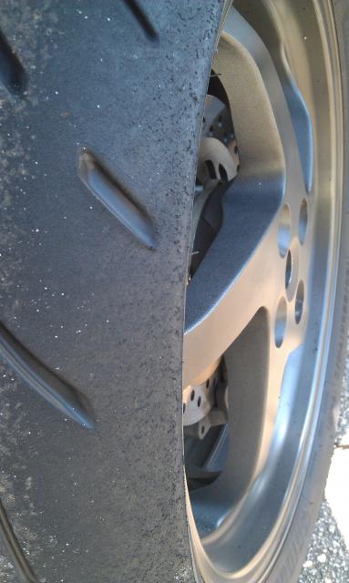

Here is a pic of the rear after a casual Skyway run:

One item of note is the rear tread is not nearly as cupped as a Road 2 or Q2 even though they turn the same shade of blue afterwards. The front has almost no detectable deformation at all in 1,100 miles which is an all time record for any VFR I have ever owned. I really need to cycle through another set of Dunlops and Michelins to see if raising the rear is the reason the bike steers so effortlessly now but I'm hooked on that S20 black tar.
