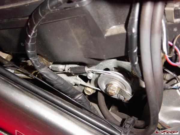

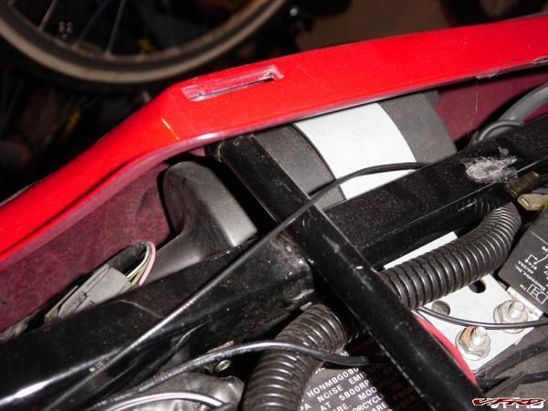

I've had the Audiovox CCX-100 on my fifth gen since '04 (Might be the post Capt G is talking of). It has worked great all these years. I mounted the control pad on the throttle side. The canister/module is under the righ rear seat plastic. I had a homemade PVC Vacuum Canister under the seat for a while then removed it and still had plenty of vacuum for operation. I just got back from a ten day European Bike Week trip to Faaker See, Austria (Ride report soon) and it quit working on way home just north of Rome. Will let you know if it is something simple to fix (I hope).
