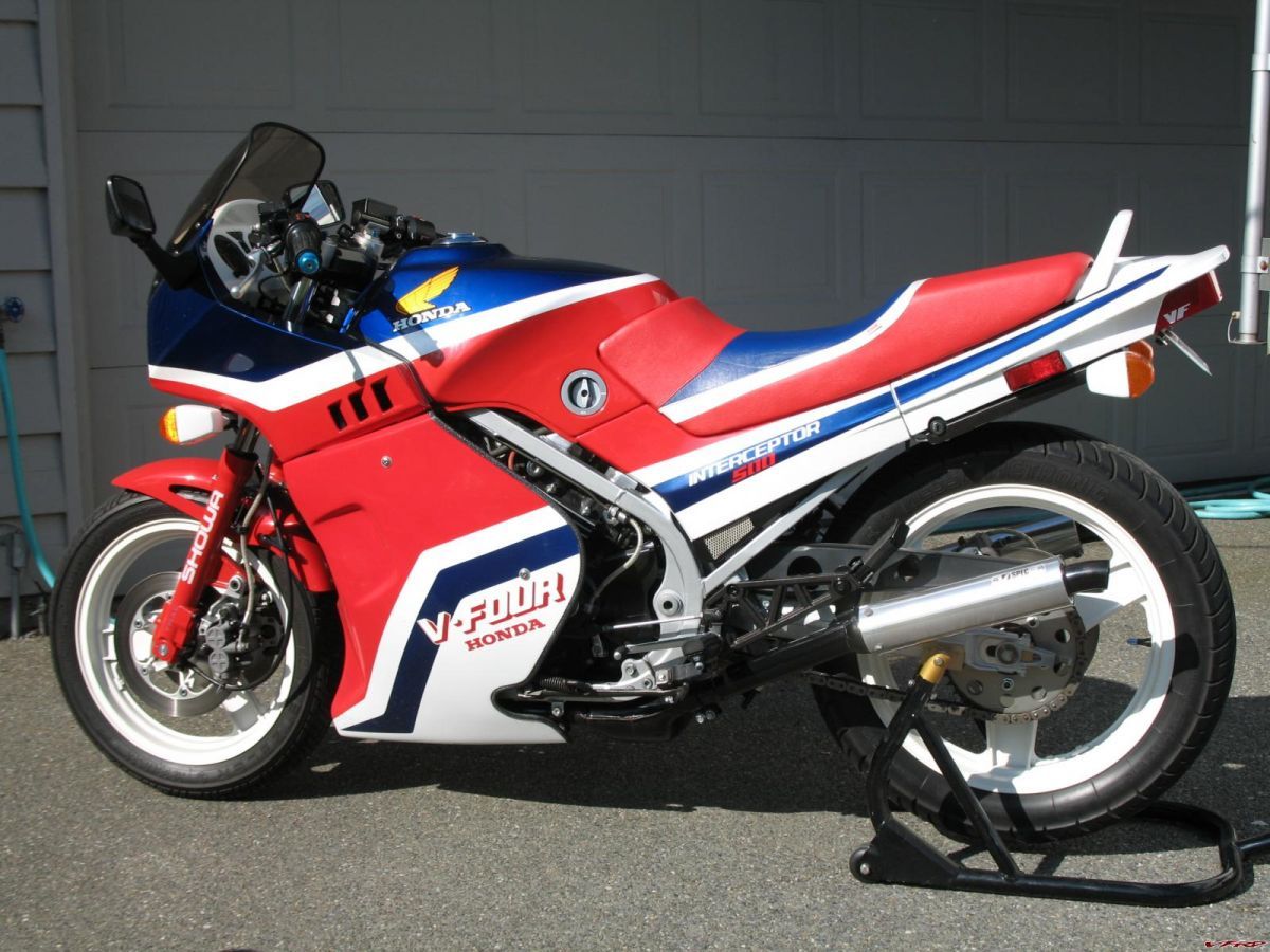

If I'm not racing or doing track days, I wanted to at least be able to enjoy this bike sometimes. Re-installed the starter, starter clutch, stator and flywheel, reg/rect, starter solenoid (was bump start and total loss with small sealed scooter battery). Installed radiator fan and thermostat. RC51 handlebar switches. Fabbed some brackets to hold a stock taillight and license plate holder with turn signals. Mounted a light I had in the opening of a headlight hole cover. Temp donor tank on there while I clean up the inside of the original.
[image: gallery_6115_3620_1093454.jpg]
[image: gallery_6115_3620_362951.jpg]
Pretty fun on the street. Need to soften the suspension a bit. It is also a little <ahem>... loud. But I can short shift it when needed. Riding position is fairly aggressive, but I won't be touring on it. It's really just to fuck around on and ride to some events. Just too cool to just sit there in my shop and I didn't want to cannabalize it for other projects.

I actually fully restored it FOR racing. I painted the frame, swingarm, forks, triples, wheels, engine... well... everything. New bearings throughout. I would like to do some kind of real upholstered seat on the race tail that integrates like a stock seat to the tank. That would help with the seat to footpeg relationship. And I already have an 86 in street trim...
Why is the fairing spaced forward? and did you ever weigh it? Right nice, by the way.
Yep... to clear the clip ons, which are very low and forward. Moved the dash forward and up as well for clearance and to put the tach in my face. I didn't want to weld up the steering stops for a full 5 degrees of steering. Recipe for putting it down in the pits or a parking lot. REALLY glad I didn't now that it's a "street" bike again. Will be weighing it soon...
