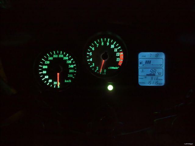

you will need these
Instrument Lights - T10/T8 LED 194 WHITE (T10 8-SMD LED Wedge White)
Oil/Neutral - T5 / 3774
I had put blue but moved to White ...
Dashboard
Dashboard
