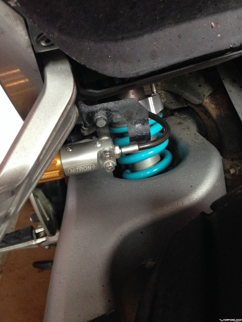

Does anyone else have a Nitron shock fitted to their VFR1200?  The OP in this thread said he bought his 2nd hand so I am not sure if its the correct spec for the bike of just one that Nitron was able to fit.  My main question is, does the remote prelaod adjuster mount to the OEM preload adjuster mount?  Any pics of the install?  Thanks
I have a new one fitted to my VFR1200. Absolutely brilliant. The preload adjuster does fit to the OEM preload adjuster mount. What I am looking into is shift it to where the servo motor currently resides once I get the Guhl ECU mod.
Thanks for the response.  In the first picture in this topic the hose coming off the shock looks almost kinked as it comes off the shock.  Maybe its just the way the picture appears but, does your also take a tight bend like that?

Ah, so yes, it is quite twisted so I installed the shock 180 degrees and had the cable exiting the other side, then there was a far more gentle radius for the adjuster.

Here is the Nitron installed on my 1200, note the adjuster cable is not kinked. I just got the standard model with the remote preload adjuster. I am very happy with it and it is far more compliant that the OEM one.
