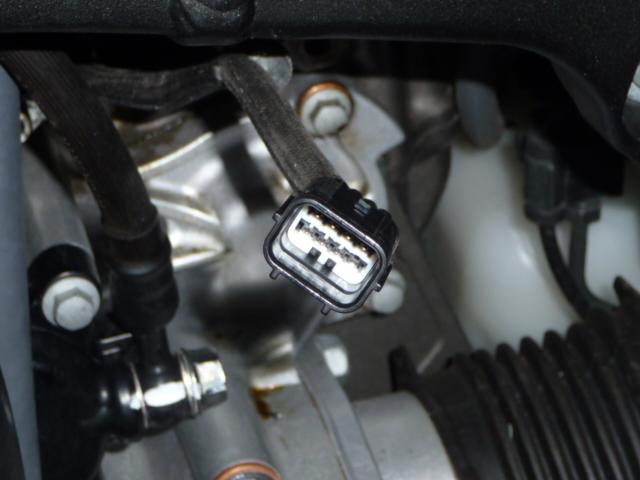

I have chanced the scematic a bit. I have made de de restriction switchable. Some testing learned that when using sports tires ( i do ) in cold weather or in the wet its very easy to spin the rear wheel.
Phobe had alterted the wiring near the ecu. I have made the mod near the GPSensors connector. Its just a choise
[image: post-20539-081796300 1287037092_thumb.jp]
Now you have individual switches for 1st and second gear... Good idea I might do the same. It's probably advisable not to flip the switches when the bike is in first or second. Otherwise you could throw a fault code.

Can you figure out wich molex connector it is ( Gear position sensor harnas near the switch ) ? Thank is advance !
Who can provide me 2 pair of Gear Position Sensor plugs. 2 male and 2 female plugs. I Will send you a wiring harness back with switch-able 1st and 2nd gear de restriction abillity .
[image: post-20539-0-68703100-1294081161_thumb.j]
post-20539-0-53420200-1294081126_thumb.j
It is a 8 pole connector with 7 poles used.
Edited January 3, 2011 by Dutchgixxer

[image: 5734ebbfbdce1_post-20539-081796300128703]
The wires for the first and second gear positions have to be cut and connected to the switch.
If the connectors are available i am willing to produce and sell a plug and play derestrictor .
Edited August 31, 2011 by Dutchgixxer

DutchgixxerWho can provide me 2 pair of Gear Position Sensor plugs. 2 male and 2 female plugs. I Will send you a wiring harness back with switch-able 1st and 2nd gear de restriction abillity .
This looks like a connector I have on my acura. Will get back to you
Plug & play de-restricting mod with no cutting and easy to return to stock protecting my extended warranty that has already gotten me a free new $1,115.91 ECU once that can now make my VFR1200F bring my front wheel up in 1st gear throttle only is how I want to play the game.

The Female Connector The male Side
Are these correct?
Have you guys checked with Eastern Beaver? He seems to have access to all kinds of OEM electrical connections that the outside world can never source. He's helped me several times in the past. It would be worth a try.

Sorry for the delays. Connector only made at certain times of the year. It's ready.
[image: VFR%20Z-bomb%20charts.jpg]
Edited January 27, 2012 by Bazzaz
#137
Bazzaz
Brilliant.
I hope you've got a good stock of those connectors :)
Did you think of adding a switch so that we would effectively have the option of traction control?
