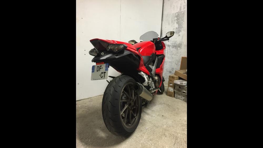

Has anyone found a fender eliminator / tail tidy for the 8th gen yet ? I have been search online for a little while now with no success. I am interested in what other 8th gen owners may have found.
Like this, its a Competition Werkes fender minimizer kit. Its stainless steel and made for the vfr1200. You just have to cut the tab off of the top to make it fit the vfr800. The OEM piece drops off with one bolt. I used these smaller reflectors to mount it. Since I took the 2nd picture I replaced the plastic OEM bolts with 2 more reflectors.
http://www.competitionwerkes.com/products/Honda/2012/VFR1200/fender-minimizer-kit-1H1200

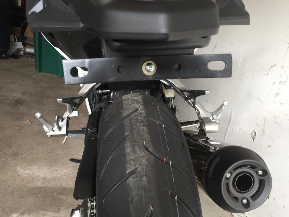

I've completed my design for a tail-tidy/fender eliminator specific to the 2014+ VFR-800. I'm now in the process of prototyping it. My design includes a High Intensity Prismatic (HIP) film reflector to satisfy the roadworthy requirements of most places - oh and the reflector will have the VFR logo-type on it. The plate mount will accommodate Australian, US, & UK numberplate sizes (probably others as well but those are the sizes I checked), and each tail-tidy will be made from 2mm aircraft-grade aluminium that will be finished with a weather-proof matte black powdercoat.
Let me know if you'd be interested in one; larger production volumes will naturally drop the per-unit price. VFRD discourages advertising and fair enough, but my goal here is to provide something that enhances the look of our bikes that's so far missing from the marketplace.
Just curious, what is the reason for the extra 44mm tapered part extending below the plate? I would prefer nothing visible below the plate. Other than that, I like it and would be interested in getting one.
Same question as DriverDave, I assume that will be to support the larger number plates of other countries. Would it be possible to make two versions, one without for North American market and one with for the world market?

Prototyping Update. Some further adjustments still needed, but overall I'm happy with the fabrication & design. I'm now just waiting on the new reflectors to confirm that everything fits nicely. Then it's full steam ahead with the production batch, powdercoating, and assembly ready for delivery.
Question for those who've expressed an interest:- Are you happy to drill your own numberplate-mounting holes? That way you can tailor it to your specific numberplate size. I've had one-size-fits-many tail-tidies in the past, but they never seemed to fit the spacings I wanted to use for my mounting bolts. The material is 2mm aluminium, so a battery drill with a metal or riveting drill-bit will do the trick.

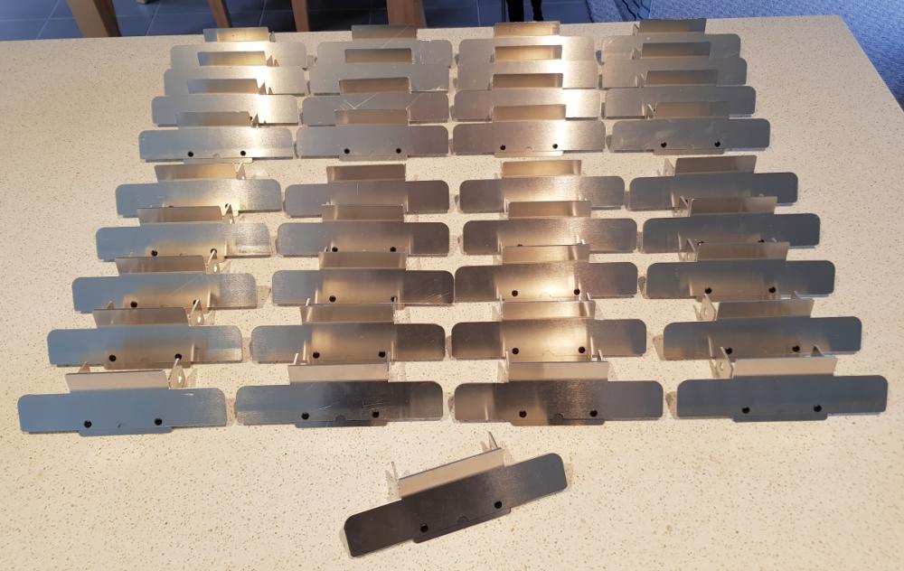

Update:
The production batch is back from the laser-cutters, so this weekend I completed the riveting, welding, and tolerance testing. Next, they're off to the powder-coaters, then it's just a case of sticking on the reflector logos and mailing them out.
If you haven't already, please send through your delivery address. If you want to order a tail-tidy, there's still time to do so as I made 12 extras - but those shown in the pic will be the only batch. Get 'em now or miss out!! :fing02:

Sending possible in France ? How about the size of the plate(210mm by 130 mm)
Love your work mate.

And french people complain about the size of their plate. Ahaha. In UK that's worse !
[image: Screenshot_20180106-230808.png]
