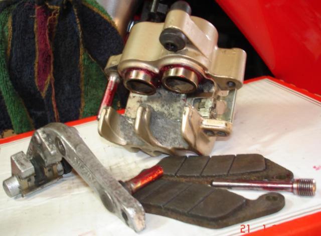

There is a specific tool that is like a reverse pair of pliers - it fits inside the recess of a piston and expands to grip the inside. Twist the piston back and forth to remove it. Alternatively use a good pair of pliers (with wide smooth jaw tips, not narrow pump pliers) to grip the very edge of the piston - one jaw inside, one outside - and twist. Dress any damage before reinsertion.
[post text not recovered]
Nice job John. Another alternative to get the pistons out is to hang the caliper over a bucket with one pad on the outside such that the pistons will move near completely out. I have a spare M/C on a clip on I use and fill with fluid plus spare hose,and then pump the pistons as far as they will go without falling out. From there its just a matter of pulling them out by hand. The bucket of course catches the fluid when you finally get them out.

Keep pumping the handle hard and the second piston will eventually move to the same point.
Now with them both being stuck so far out I could slide out the spanner and the pistons could then be wiggled from side to side and easily pulled free.
That tip from TheStig about the closed brake lever is working nicely to avoid the system draining down.
