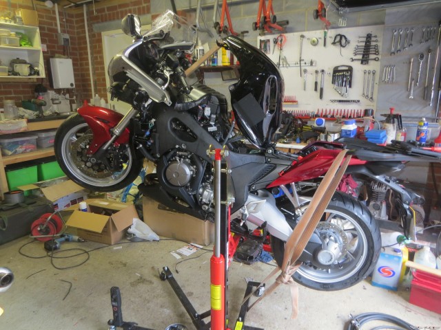

Pulled mine to bits on Saturday to fit the PCV it did not take too long  about 2 1/2 hours   IMG 1004
IMG 1004
VFR1200 on Abba Sky Lift
It was the first time I did everything (bought the bike second hand) so I took my time as to not foul anything up.  Ran out of time to do the brake and clutch bleeding, but I could see the big service taking around 4 hours total.
That work stand would be nice, my knees are sore today from crawling around the bike all day.

I would not be without the lift   My knees and back are not great
so crawling around on the floor when its only 4 degrees is not on

That lift is awesome! You paid a pretty penny for it I am sure. I am using a harbor freight lift and I think it is wonderful, but doesn't hold a candle to that baby.
Thanks for the clarification ridered. Appreciate it!
It's an Abba Sky lift they are £430 over here not sure what that is in dollars,
They are very versatile as you can raise either end or have it parallel.
