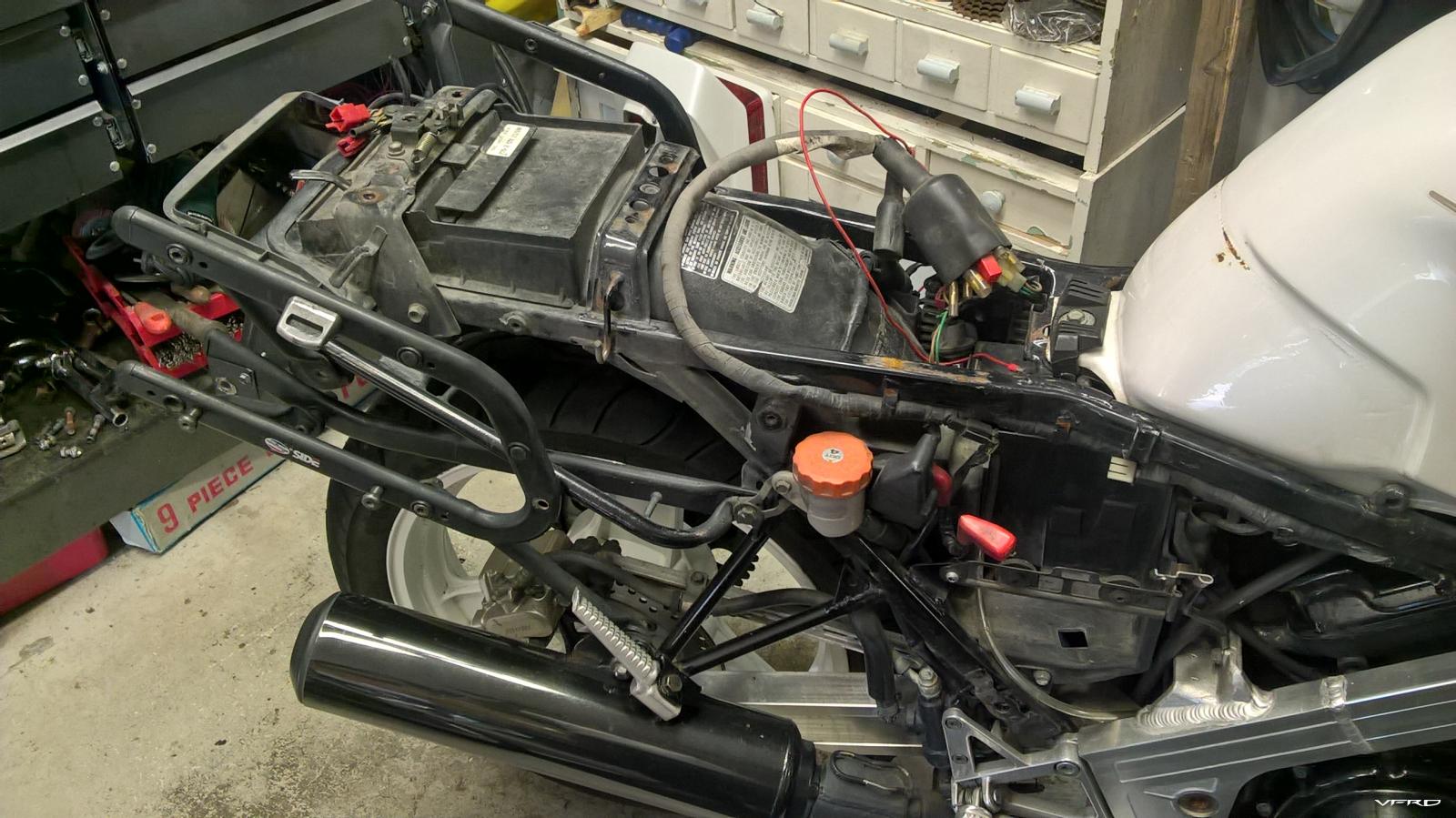

Did take off the tail part today, and looks I have to look for a new/better rear frame, as its bent slightly.... :mad:
Did wash the "half nude" RC24 as the CBX750F yesterday
Found a crack in the subframe, but closer inspection did show its in the part you can bolt off that has the lock for the seat. the rails that go to the front parts has holes drilled for the side case racks so had plan to chage them anyway.
[image: large.WP_20160917_10_50_02_Pro.jpg]
A other thing that I have to find out is why some former owner has wired the fuel pump to get power from the tail light bulb! The red wire in the pic below.
So her new nickname "white crack ho"???

They probably bypassed the fuel pump relay because of a failure so it runs whenever the key is on. Nice pics of the mounting for the bags, looks well done.

Well as I did mention the part of the sub frame you can unbolt, that has the seat lock, was cracked, and I decided to buy a other rather than weld the old, it had holes drilled for the hard side bag holders as well. So I found one on the web for sale that looked good, had even the sticker for the helmet lock, but as it came it was not as nice as in the pics, rust here and there, panted on to look nice. So I have been using sand paper to get most of and get a good finnish for it, but that´s a job I really don´t like....
[image: large.IMG_1127.JPG][image: large.IMG_1129.JPG][image: large.IMG_1130.JPG]
Also need to figure out how the change the seat lock!
[image: large.IMG_1128.JPG]

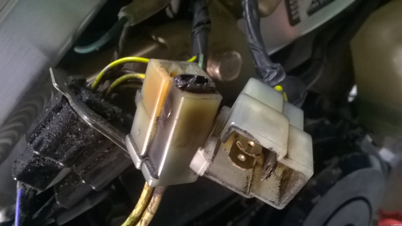

The to the odd thing why the fuel pump was wired from the tail light. Looks like te R/R is different from a OEM, its not bolted in place, glued, and the other connection is tie ziped to hold together, but seem to work OK, BUT as can be seen from next picture, no fuel cut relay present...Have to get one...
[image: large.IMG_1237.JPG]
My early 86 F1 bike doesn't even have that plug that i can find. You should be ok leaving it off though, if your lights don't work or something you'll know pretty quick once you hook it all up. I know the euro bikes have an extra connector on the right hand switch for the on/off/park lights switch, so maybe that is the deal.
For fuel cut relay the white plug and bullet connector should be what you need to go back to stock. I just went through this recently, there is a cheaper aftermarket unit out there by K&L you can modify to fit. That black two wire connector by your reg/rec connector should be the one that goes straight to your fuel pump.
On mine the reg/rec connector and fuel pump connector are hidden under this little guy:
[image: Np6TAky.jpg]
[image: P4IPi6v.jpg]
You might be able to find another source locally(if you care to replace it), but here is a source i found for em:
http://www.cycleterminal.com/connector-covers.html
As for your reg/rec woes you should remount it good enough for your liking, and then solder the 3 yellow stator wires straight to the reg/rec connector. Your reg/rec connector looks to be new and zip tied well enough, but the spade terminals are not great and known to fail on these things and your stator connector looks original. I'm waiting on a rebuilt stator now, this is what mine looked like recently:
[image: dQpnBHv.jpg]
if the fuel pump relay of a 4th gen will work,  I have one somewhere (from redslut)....
I will open up that connection from the stator, I know becorse the connector on my 3rd gen did look like this:

For the additional connection from the left switch, seem only the VFR700F2 have them, according to Hayens manual wire diagrams.
Dutchy, have any pics of the RedSlut fuel cut relay?
[image: IMAG6276.jpg]
[image: IMAG6275.jpg]
[image: IMAG6274.jpg]
Nota plug and play bit, but would proberly work whit some mods in the wires.
