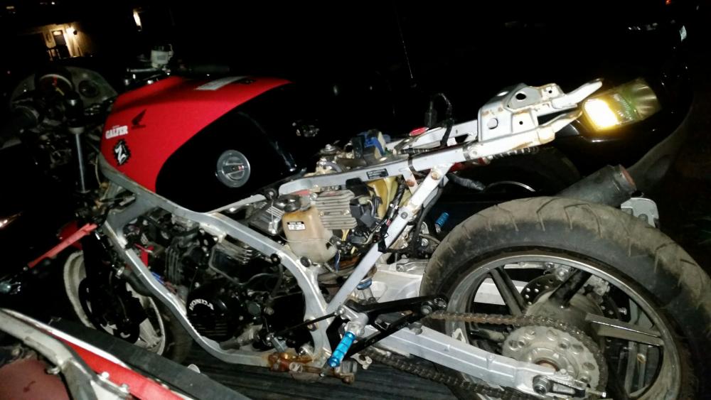

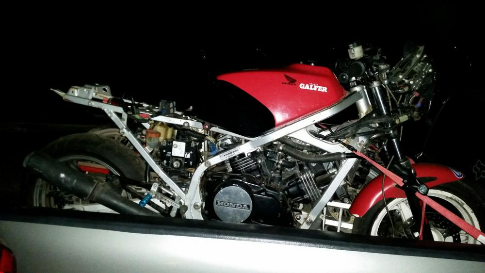

A little slow to start my thread. Bought a 1983 VF750F. No title for the 83 frame. Have title and bits swapped into 1985 VF700F frame.
Engine has custom ground cams

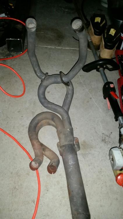

Yoshimura "muffler"
Custom? 4-1 headers
Aftermarket ignition.. Unknown rev limit status
CBR 17s unknown year
Aria pistons.. Unknown bore, dispacement, comp ratio
One or two track days in early 2000 on race built motor

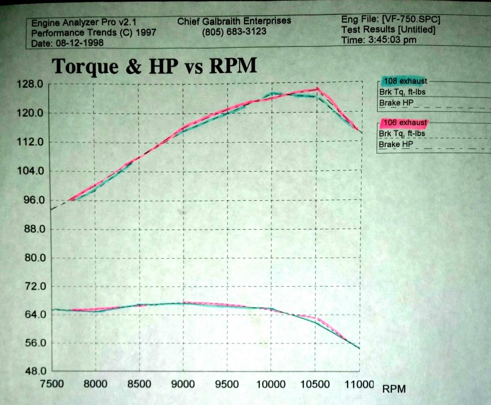

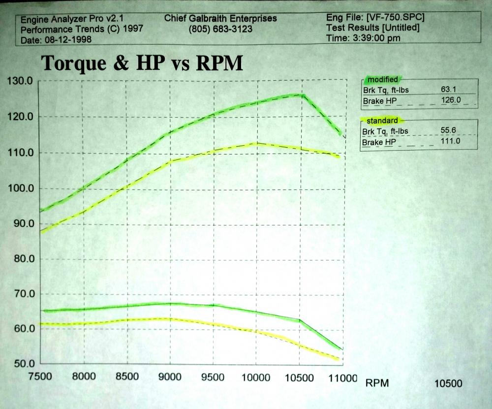

Dyno chart.. 126HP
Stainless brakes lines
Spare stock 1983 VF750F engine

Bought her 21 April 2016. The Yoshi is only a cone completely open with those stamped areas for minimal back pressure. It is VERY loud. The test ride with only a tach, hit approx 120mph according to neighbor bike speedo. Front piston dragged severely but not known at that time. Definitely has 100+ hp. Not that it can touch my 2002 ZX9R's 144HP, but impressive!

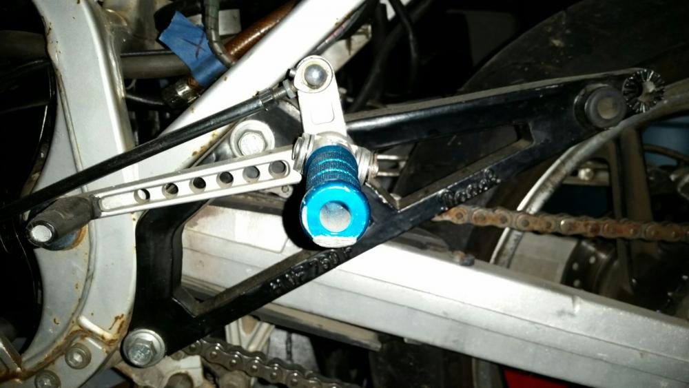

Raash? Rear sets with cheesey pegs

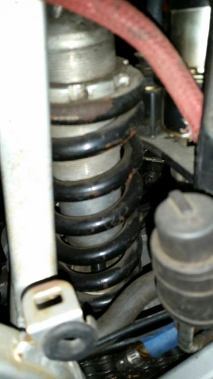

Unknown aftermarket rear shock and spring

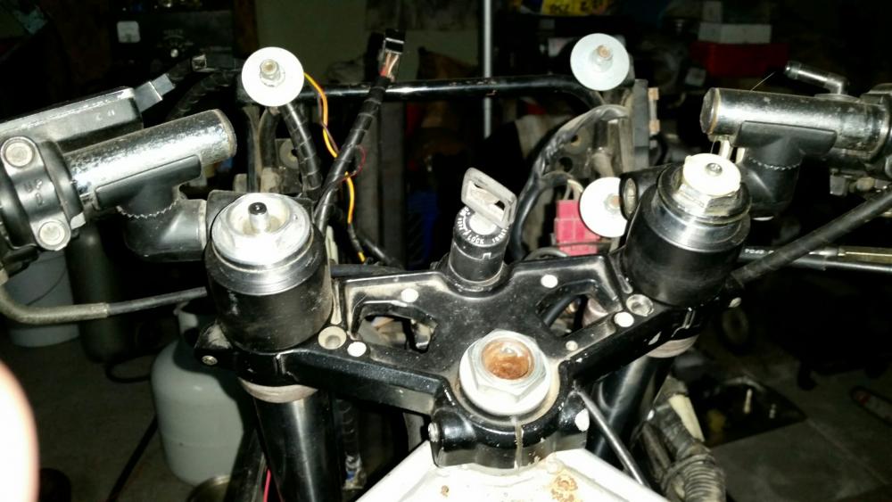

Unknown German clip ons

Let's see that dyno sheet.
The stamped baffles are the baffles, it's how they were made back then.
Ye ask, ye shall receive...

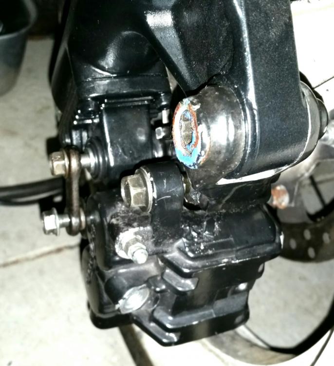

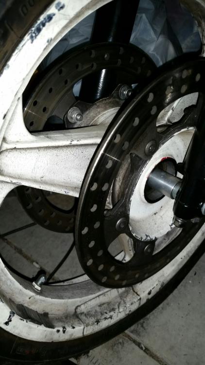

In the 8 months since I took the front calipers off for rebuild, I have lost or incorrectly installed the left TRAC arm. See the bushing in the caliper bolt is longer than the bushing in the TRAC hole of fork. Both bolts bottomed out with link still floppy in addition to not parallel.
Anybody have a clear photo of the link?
The plate/arm is in the wrong way around.. The plate (as in original) has an off-set..

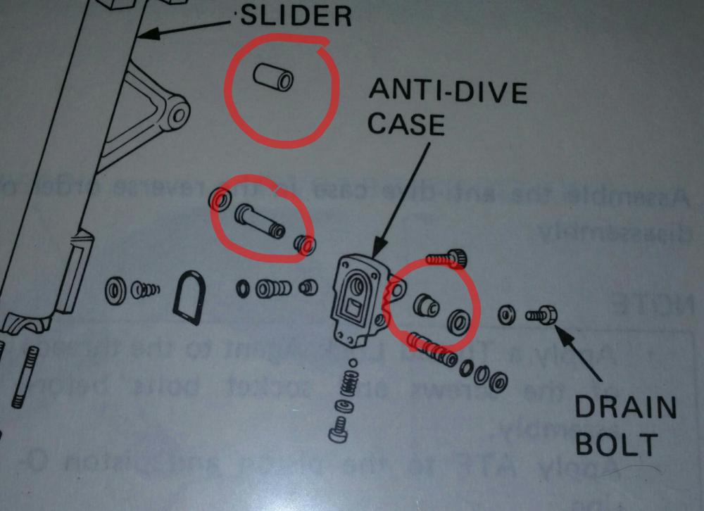

It appears I need the flanged and longer bushing in the fork leg. Flange to caliper or out?
Could also be that the axle is in from the wrong side... Axle, according the schematics goes in from the speedo side.. Nut/bushing should be on the right side of the bike.. Checked that ?? My VF is currently in storage. Could check and shoot some pics later this week..
I zoomed in on one of the pics. and this came out...
Although unknown cbr 17s with rotors and sprocket, stock front axle and brakes. Am following fsm for axle torque. Assured axle installed correctly. Right leg is torqued. Left TRAC leg controls width vs caliper mount to rotor clearance. Flange appears to go towards rotor. What are the other two items marked? Switched bushings and bolts torque down correctly now.

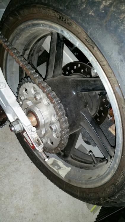

Looks like a Dymag front wheel and a CBR 600/900 rear wheel.  Raask rearsets.  Fox Twin Clicker shock.  Telefix Cipons
Very cool bike.
Trendy track bike parts or awesome parts?
Awesome parts (Except for those stupid pegs...  always hated that style)
Thanks for again being the guy with the answers! I am not too fond of them either. Will move to back and get more motocross style with some bite.

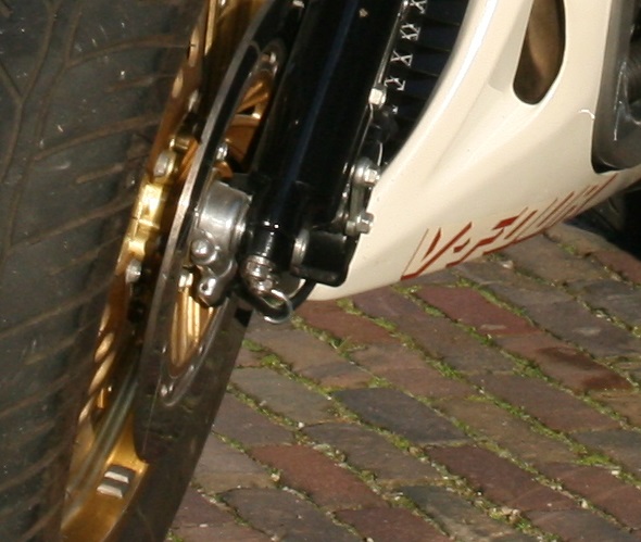

Could you have a look to see if the front rim is in fact from a CBR?
I would be very interested in some pics of your front end if it is.
Front is 3 distinct spokes and deep offset wheel bearings. The braking rotors and rear sprocket part numbers all turned up nothing when searching. Apparantly all items discontinued... Or numbers stamped have to cross to something. All calipers and mounts are stock 1983 VF issue.
Thanks for the pics. The front rim, as Captain 80's noted, does appear to be a Dymag, lucky you! I'll start to look at CBR front rims to see what would work best.
You have a very interesting 83 Vf750F. I 'll look forward to further posts.
Thank you! I looked at Dymag and it seems similar to CH3, but does not say Dymag. To test if aluminum or magnesium should tell me more.
