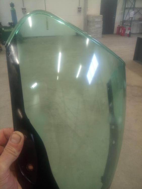

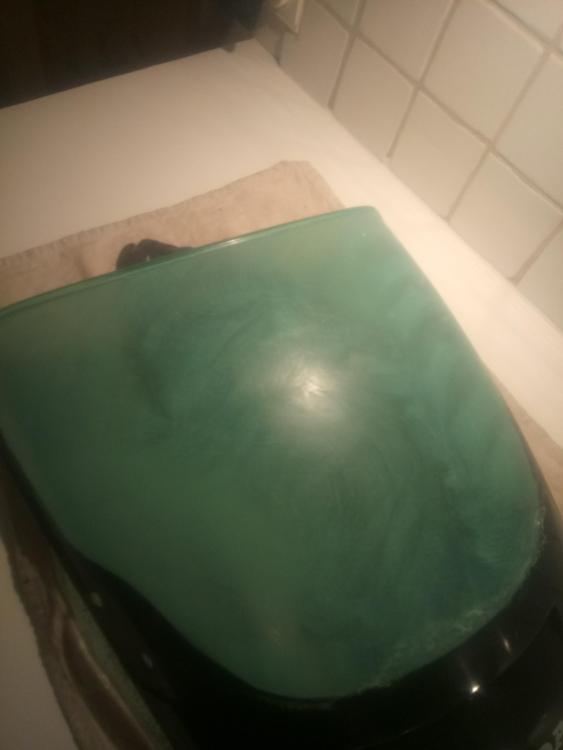

First started of trying to clean up the windscreen. Read about using toothpaste, headlight cleaning appliances and nothing helped.
It even got a little bit worse or nothing happened.
So I tried something I've been doing on car bumpers for years: heat gun. Worked like a charm!

1 - Wet sand with the finest grit sandpaper you can find.  Use your judgement depending on depths of scratches.
2 - Compound buff
3 - Repeat with decreasing grit of sandpaper and compound.
It's a tedious process and will not give you New appearance, but will get you 90% there to pass the 5 foot appearance test.
It may be easier to just buy a better looking shield.

I firstly went over with a 320 grain, next was with 600 something, 1200 and finally a 3200 grain. Everything always with water and lubricant. But I found out that to get rid of the small amount of lines from the sanding I went over the screen with some heat to make them disappear 😊pattienc isn't my best friend haha

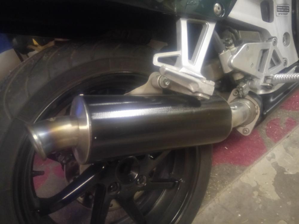

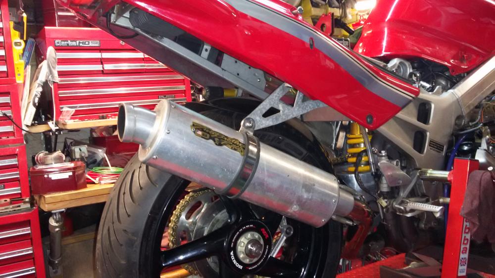

Next up was to repack the silencer, previous owner had everything removed from it, and I shortened it with 15cm as I had it loose.

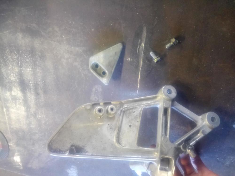

Okey, removed left foot peg and on the back side of it, there was a weight. Whatta!? Why?
Probably vibration damping to prevent tingling, ticklish feet.
Aha! Never seen that before. #removedweight 🙃

As I've had much of the non-motor parts disassembled over time, I've observed that there are rubber vibration dampers all over the great machines. It's one of the fabulous features of these terrific machines.
FYI, 4th gen peg hangers fit 3rd gens, and look a bit less "weighty".
I hesitate to contradict my good friend John, but swapping 4th gen brackets to a 3rd gen is more involved than it appears.
Whilst it is true that the 4th gen footage brackets will bot straight into place there are problems. Iirc, on the left side side there with the small metal fairing.
The right side is complicated due to the rear brake master cylinder and the heat shield. Nothing unsurmountable, but it complicates what looks at first like a straight exchange.

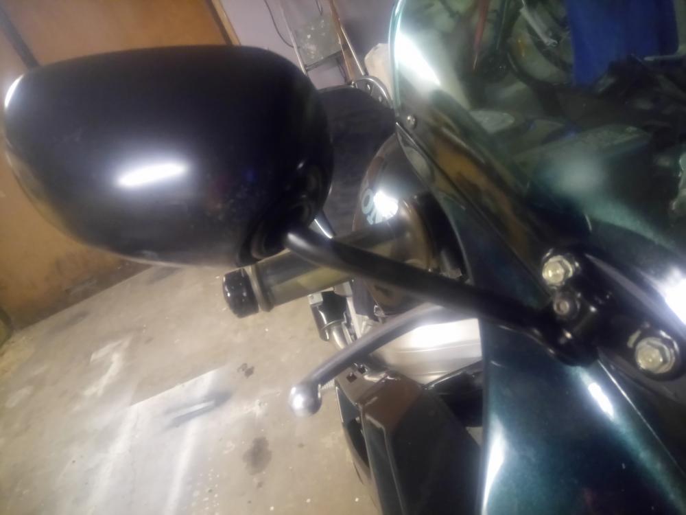

This is how my mirrors look, easy to get rid of to track days

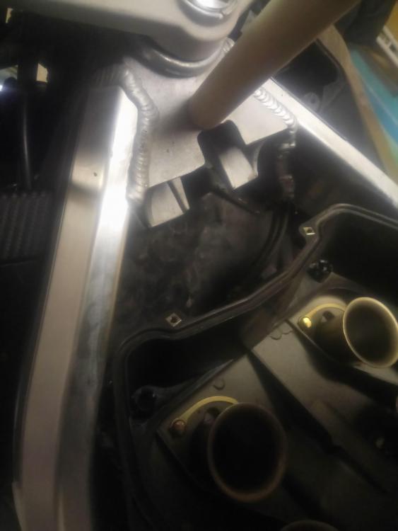

So, after a good long day at work, I got home...and did more work.
Removed the plastic guard in front of the snorkel. Happy days. And mounted a bmc sport filter as well 👍
The snorkel increases the velocity of the air into the air box, removing it is futile - it'll make the bike a bit noisier and that's about it, might create flat spots in the rev range
Oh, I didn't remove the snorkel, just the plastics between the radiator and the inlet.
No driving today... It's snowing again 🙁
The plastics are meant to act as a heat shield to stop the air flow from warming up. Doubt it'd make much difference but every degree counts!

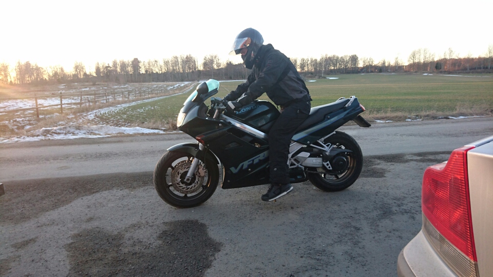

Today I drove 30km of total 100km on a vfr. It's been 6 years since I rode a sportbike.  My striping on the rear tire to analyse my lean angle shows so far 5mm more leaning towards the left than my right.
It'll be interesting to see how that develops since it's just the beginning of the season here in Sweden.
5mm is not much difference, really, unless you're working things out and training on a race track. Most riders in drive-on-the-right countries may be predisposed to lean more and more naturally to the right. Then there is the variable of the crown of the road depending on your lane position when leaning over.

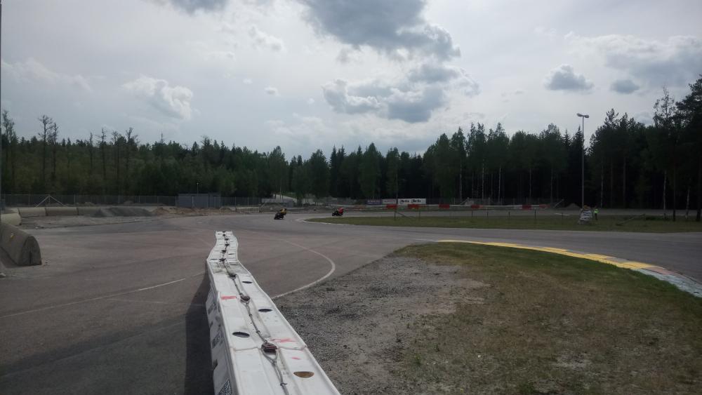

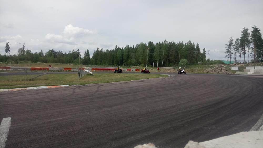

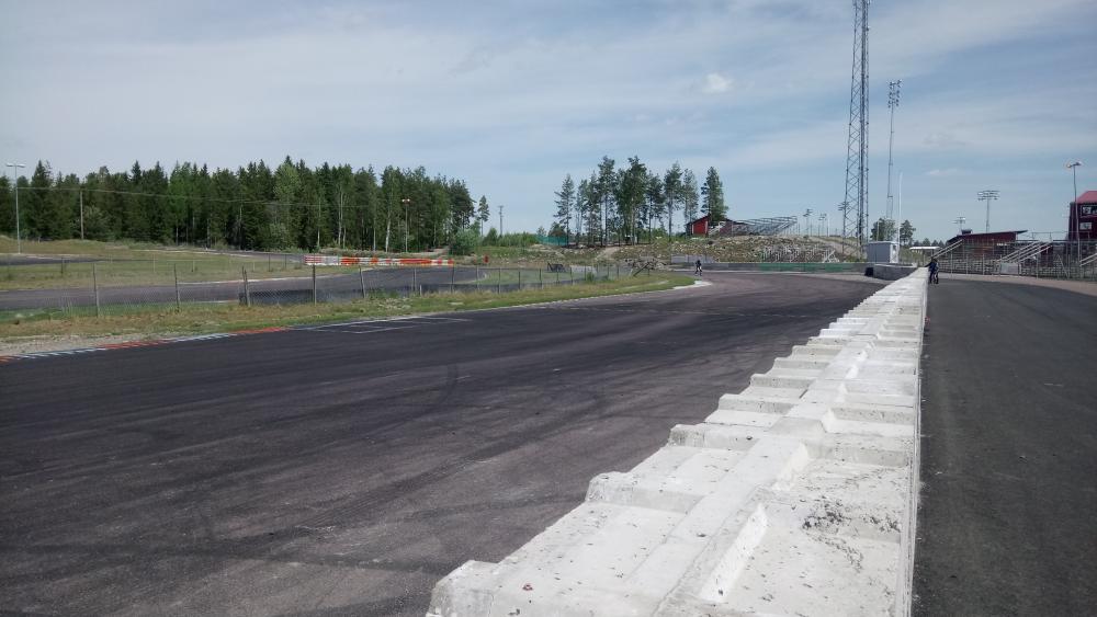

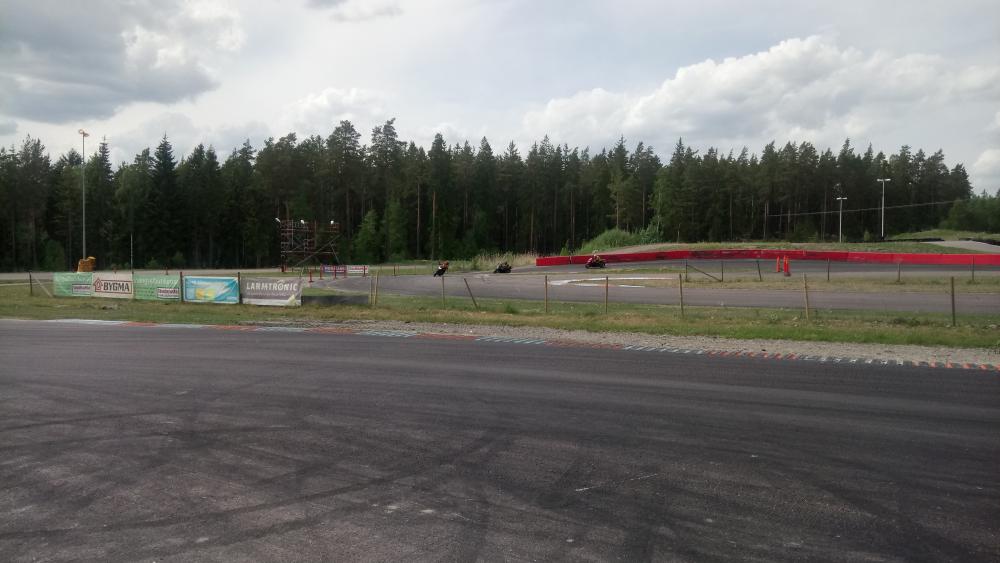

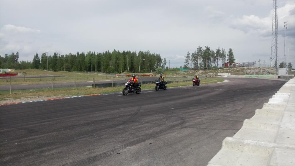

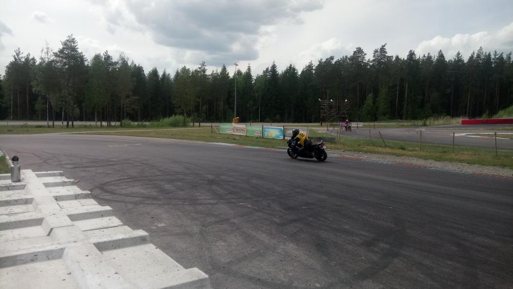

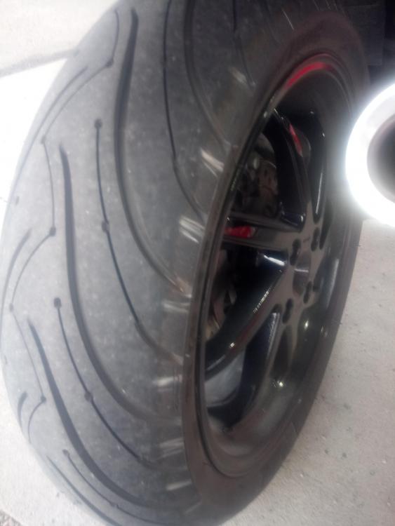

So. The first track day went beyond good. I rode with some more inexperienced riders, but with everything from bmw s1000rr and aprilia touno apc to triumph Tiger 800. The bike did great! But, I felt like my tires was really slippery.
Got them to good temperatures but still they wanted to skid in some turnes.
What tires are you using?
Hej Jock!
I use the same Michelin PR4 as you on my 6th gen, and I have not experienced any slippage. I've only done Knix on a go-kart track, but I was able to lean the bike down so far that the exhaust on the right side (the part that exits the catalyst) touched the ground and then full throttle (with VTEC transition) without the rear tire losing grip.
I did notice some extra leaning when initiating turn ins when the tires were cold, but the grip was there if I pushed them.
I'm really REALLY impressed with the PR4's! Please tell me if you find anything better though. :-)

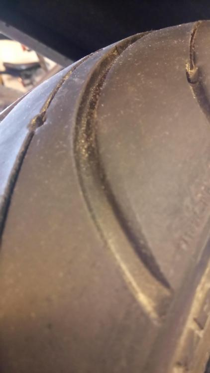

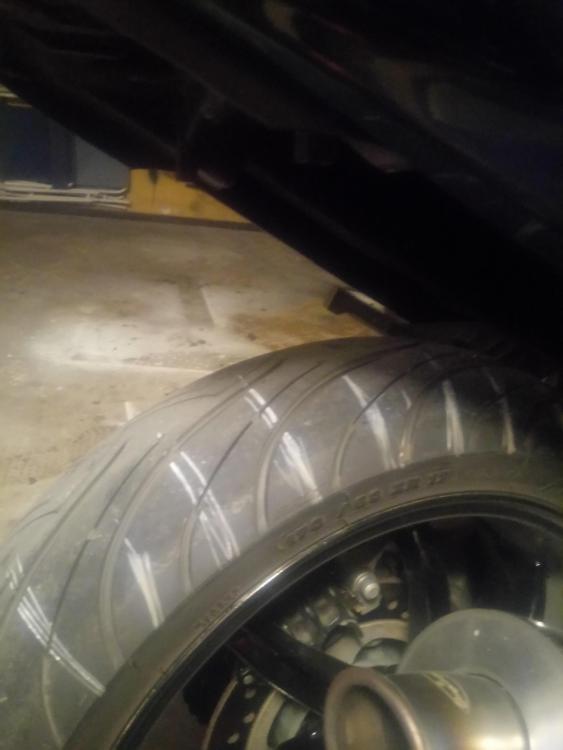

I looked on the treads for the rear tire and it looks like, if I interpret it right, as if my rebound was either to stiff och to loose. Any suggestions?

So, after some evaluation of the tire, I found out that it was 0.7bar under inflated (😱😱😱) and I hope it is due because of a faulty nozzle and not because of anything else. Filled it up with some 2017 air from the compressor and hope to see leakage.
It might be old rubber and the lack of the bike being ridden often by the previous owner this has been overlooked.
Cause of pressure loss in the tire : broken air nozzle. 👍
2 hours ago, Jock3
Every new tire should automatically get a new valve unless the existing valve is a good metal one. Then it should get a new core. Why dealers and service guys who mount the tires won't just spend the extra 10 cents for safety is beyond me.
