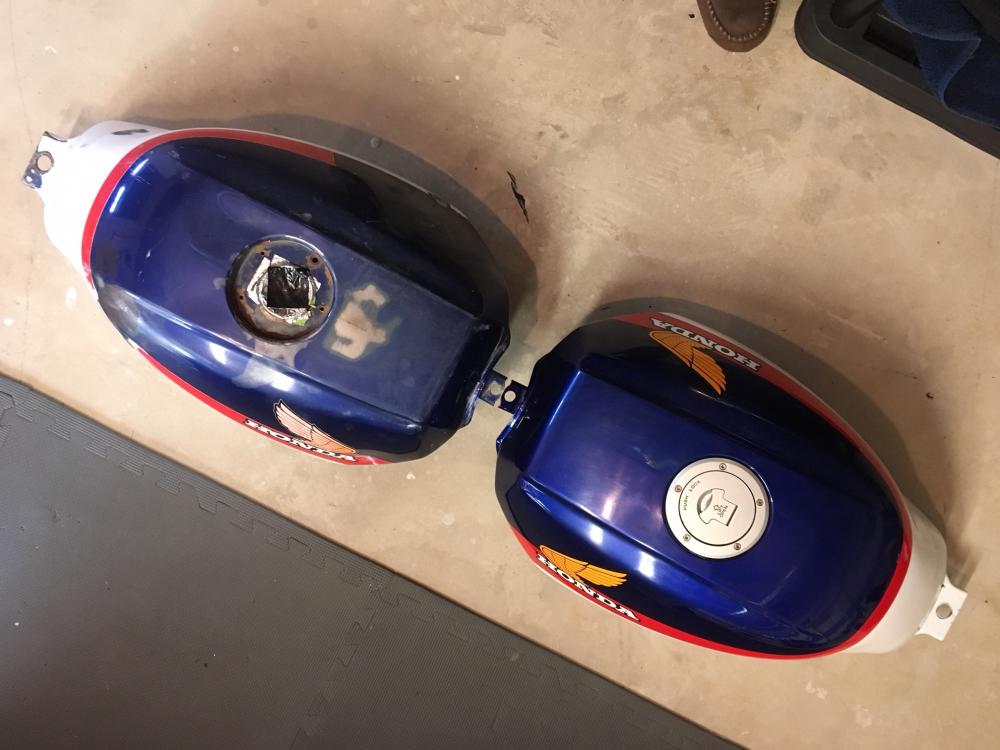

During the disassembly process for my latest project I discovered something I can't really explain. The fuel tank I refinished for this project came from another bike. When I went to fit it onto Project 18 it was...too wide.
The rear portion of the tank slips between the subframe rails and this tank simply wouldn't. After taking measurements from four other bikes, I determined that this particular tank and it's subframe were actually wider than the others.
[image: Picture]
The larger tank (on the right in this photo) measures a whopping 1 1/4 inches wider at the rear and 5/8 inch wider at the mid point.
The subframes measure the same at the front (frame) mounting point but 5/8 inch wider at a point near the tank's rear mount.
I've never encountered this before, but then I've never had an occasion to measure tanks, assuming they're all the same. Did Honda get a batch of "Fat Boy" tanks from a supplier and just build a wider subframe to accommodate them? Are these tanks for a different market?  There's nothing special or different about the bike this came off that I can determine; it's a 1986 750F, RC24, production number 651.   Anyone have some insight into this mystery?   Joe http://v4dreams.com/the-shop-blog.html

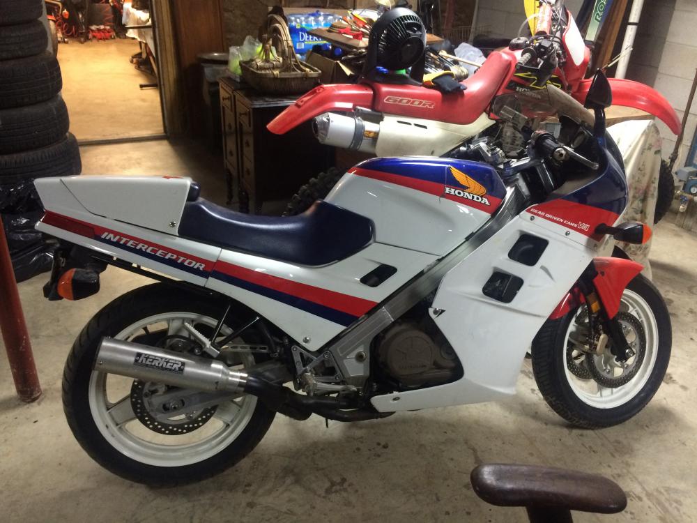

IMG_0995.thumb.JPG.512993def61ca2efd7801853be05870a.JPGSee above: RC24, 1986 VFR750F, R/W/B, production #651. Here's a photo of the bike the day it was delivered to me.

Sorry, I read it wrong.
Very nice bikes.
The 750 had the lowers swapped out at some point?
Pre-production bike tank as subframe?
Yup, different fairings.
I thought of the pre-production angle. I can't believe Father Honda would allow that to happen. And the bike is #651. I've had earlier and later bikes, but, as I noted, I'd never had the need to actually measure the tank/subframe.

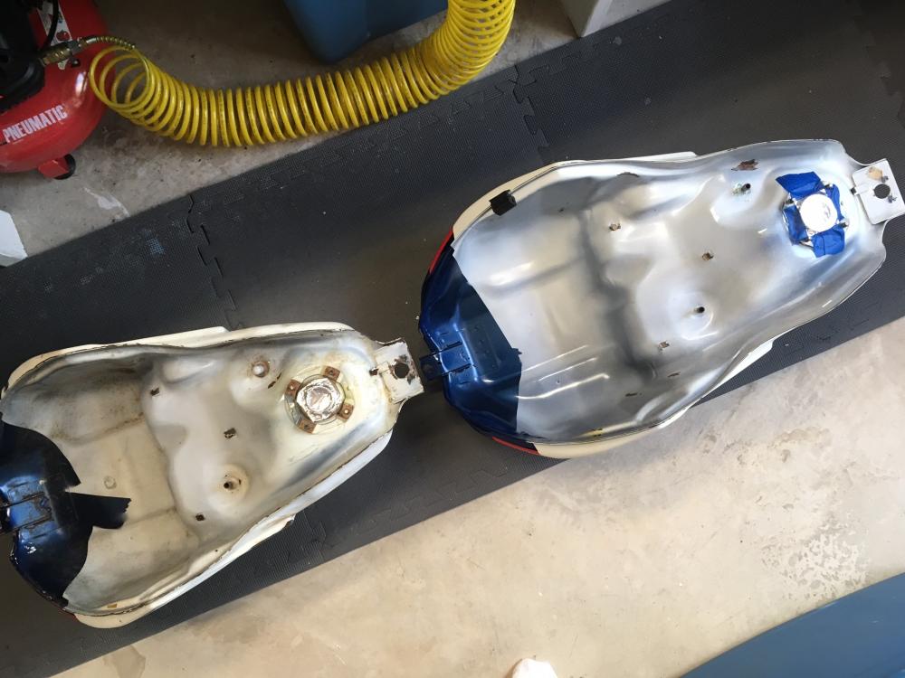

Good theories....... Here's some additional comparison photos (Fat Boy on the right):IMG_3141.thumb.jpg.f285cab7f4878faa25057e859cecf265.jpgIMG_3144.thumb.jpg.82e20b32fd258b6d6269bc965c1fb343.jpg
Have you been able to measure their capacities?
No, but that would be interesting. Larger capacity for endurance racing? I can't imagine it would be much more, maybe a quart (liter)?

Are the bottom of the tank seams bowed out at the back or is it just the camera angle?
No, just the camera angle. All the stampings, proportions and contours seem identical.

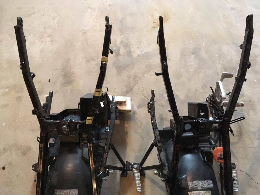

If you get a chance, please show a picture of the sub frame area where the width is different.  I would love to take a look at a couple of mine for comparison.
Weird.

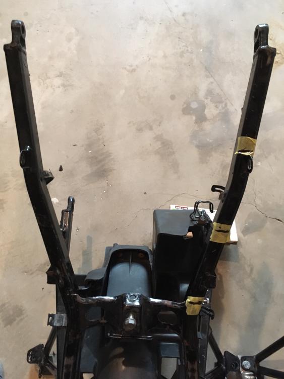

Here ya go....
I took a few minutes to do some accurate measurements. Referring to the photos, I took measurements of the subframe at the front mount, 6" back, 10" back and 14" back (indicated by the yellow tape).
Front= wide frame 11", normal frame 11 1/4"
6"= wide 9 3/4", normal 9 7/8"
10"= wide 7 7/8", normal 8"
14"= wide 6 1/8, normal 5 7/8"
Some of the difference is most likely due to manufacturing variances, but the first three "normal" measurements are actually wider. The telling difference is at 14", near the rear tank mount.
Speaking of the tank, I measured the tank at the widest exterior point (at the "Ho" in the "HONDA" decal): wide tank= 16", normal= 15 3/8"...
...and at the rear flange's widest point: wide tank= 9 1/8, normal= 8 3/16.
As a control, I measured a second "normal" tank; when compared to the first normal tank it's the same at the widest point and 1/4" narrower at the rear flange. So maybe they're all a bit different, but that doesn't take away the fact that the Fat Boy tank won't fit on my other subframes. Hmmmm...
Joe
